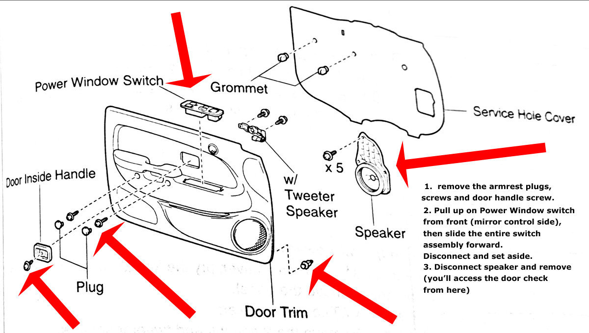

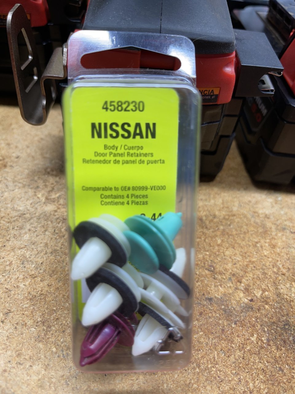

    I removed my front drivers side door panel on my 03 DC today. I wanted to measure my door speaker size. Well I broke several of the brittle 20 years old plastic push pin tabs. in the pic below I need the part number by the red arrow that says Door Trim. I tried using one from a parts store but it doesn't lock in very tight. 1212.jpg

    These clips break all the time when removing door panels, I bough a bag off of Amazon for cheap i think the dealer wanted a couple bucks per clip

    90467-09206 - Retainer, Front Door Trim

    These work from oreillys

    I did some searching and reading customer reviews of different ones available. I ended up ordering the new ones from toyota. A little pricey, but sometimes the OEM are the best, at least that's what I'm hoping for.
