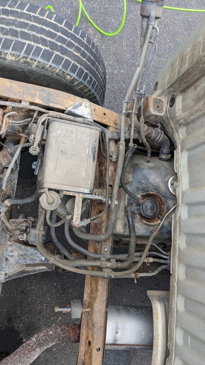

    So I pulled my bed off to derust and paint the frame (at least that was the excuse I used to also buy a OME suspension upgrade as well) and found rodent damage to various hoses around the fuel tank. Most of the hoses are damaged so I'm going to replace all of them.
    Does anyone have a diagram that shows part numbers for these hoses? For some reason I'm coming up empty...

    Head over to
    https://www.partsouq.com/en/catalog/genuine/locate?c=Toyota
    and enter your VIN. You’ll be able to drill down to the relevant section and get the info you need. They also have really decent prices. It may take some time learning to navigate the part diagrams but when you do you’ll be looking up parts with ease. All the info is there.

    Similar to partsouq that Mike @Area51Runner mentioned, you can also head head over to this site and enter your VIN and then drill down on the parts diagrams. You can’t buy anything there, but they list all the part numbers and you can use those numbers on any Toyota parts website to grab the hoses you need.
    http://japan-parts.eu/toyota/us
    Specifically, I think you’ll be interested in this picture for your VIN (which might be the same picture, as I tried to be intelligent in the choices I made on the site): http://japan-parts.eu/toyota/us/2004/tacoma/vzn170l-crpdkab/3_674460_008_/body/7751_fuel-tank-tube/2
    Hope that helps!

    Might want to consider replacing that crossmember before the rust completely compromises it if its too close to gone. I found one off ebay. If the tank strap is super rusted, rockauto has em. You need the long one if you have the 18 gal tank.

    Yeah I'm looking at that, going to pull it off and clean it up, if it is compromised it'll be replaced for sure
