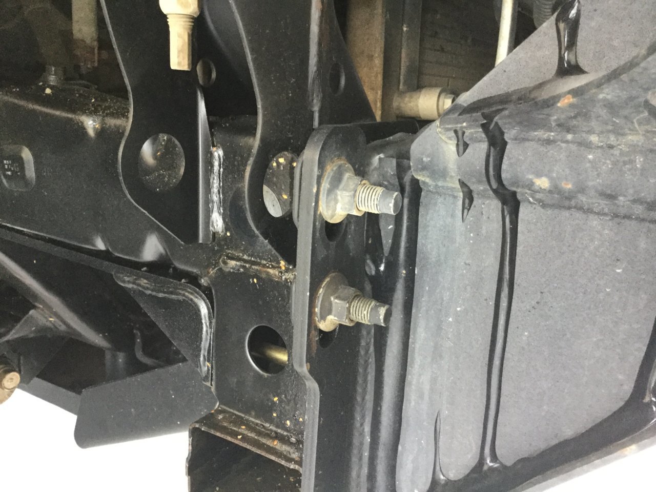

    Reuses the same bolts that are already on our trucks:
    Two on the crash bar ends and then one in the top hole on each side. Easy.

    I've got the 2012-2015 install instructions. Should at least be similar. I didn't see anywhere to grab the 2005-2011 one. See attached.

    Install should be the same. Only "difference" is cosmetic.
