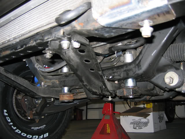

    Could someone post a picture of the the Toytec Front Diff. Drop Kit installed on an 05+ Taco? I was reading the instructions that came with the kit and they do not match my truck. It talks about removing the front skid plate removing 9 screws. Huh? My skid plate only uses 4. Also it talks about adjusting the mounting holes on the rear skid plate. Huh? My 2005 DC doesn't have a rear skid. Thanks!!

    This is what it looks like:
    And no, you don't need it.

    Why are there 2 spacers on the top of the crossmember ?? I will be installing one to get my CV's back at a better angle, I don't want to have to keep replacing boots, I've already done it once.

    I knew someone was gonna ask. They shipped me the wrong kit and bolts were too long so I had some spacers made to take up the slack.

    Lol couldn't just run up the street and get a shorter grade 8 bolt for 2 bucks?

    I thought the whole idea behind the diff drop was to "help" with CV angles... Does it just not help enough to make a difference? If it doesn't, then I'm gonna remove mine since I'm installing my BB skids. I'd have to fab something up to make them fit with the skids like Silverback did...

    being as a 1" drop only lowers the axel 1/2", wich translates to a 3* or so change in CV angle, it really doesnt make a big difference.

    Just found it. Installed spacers and longer bolts to drop the full skid setup a bit. That was the first option I considered but went with modifying the skids instead.
    Honestly, after all is said and done, no diff drop really is the way to go on our trucks.
