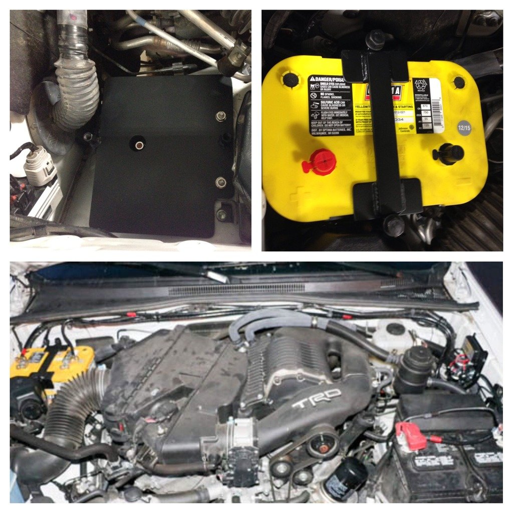

    @cruiseroutfit Thanks a ton! My only other concern is routing the intake around my secondary battery location. I'm pretty sure it can be done, but it might take some extra work. If it simply hooks up to the stock intake location I should be fine. I'll definitely order through Cruiser Outfitters. Here's a pic of my dual battery set up, so you can see the limited room I have on the passenger side.

    The snorkel comes into the engine bay in the exact location as the stock, so non-issue with your battery.
