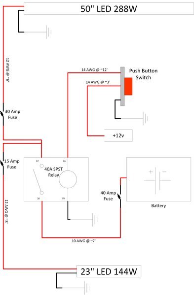

    I bought some LED light bars off of Amazon and I stayed up all night thinking about how to wire this setup. Below is a flow chart of what I have come up with. I am a FIRM believer in doing things the right way once. So please share your opinion and if you see a flaw in my diagram, let me know.

    What hasn't been modified?
    Don't see any real flaws in it.

    Nothing wrong with it, more complicated than need be. I use relays where they're not needed sometimes though.
