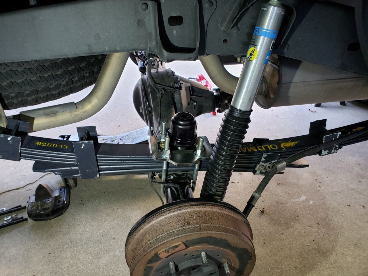

    Hello everyone. Need some help! What can I do to improve UP travel and/or bottoming out??
    The rear is bottoming out too easily for me. I have a dclb 4x4 tank. By the way no extra weight, just a soft roll up tonnau.
    My current set up:
    Front:
    - Bilstein 6112 coilovers set at 6/5. LOVE these. Very impressed and I don't think I've bottomed these out.
    Rear:
    - Dakar medium EL095R. Handles 1000x better than stock.
    - Bilstein 5125 shocks
    - Wheelers superbumps (awesome)
    - Wheelers flip kit
    Any thoughts or ideas are very welcome.

    How are you bottoming out? From flex, jumping, or overloading?

    Are you hitting the u-bolts?
    I trimmed mine.

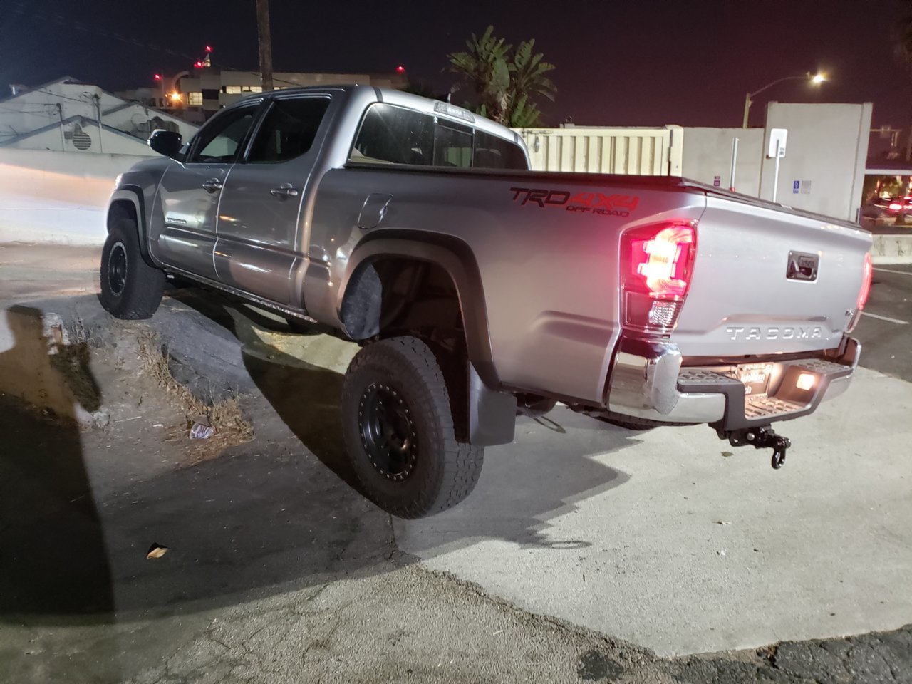

    There are a lot of dips near my house. My 4runner can bomb them at any speed.

    Is the shock bottoming out before the bump stop?

    No pretty sure I'd feel or hear that. It's not a harsh bottom out.

    Then short of shock mount relocation and longer shocks, 3link or 4 link not much. You should not be bottoming out on dips in the road that easily.

    Looks like you have strong enough springs. My guess would be the bump stop is too tall. You could try removing it, replacing it with something shorter, and seeing if you bottom out. But, cut the bolt ends first.

    I would measure first, that shock fully collapsed is 15” if you bottom them out a few times you will destroy them.

    You are right 15" collapsed. Pretty sure lots of folks run the same set up. Good thing they are cheap if I blow them out lol. When I installed I measured. Gap between bumpstop to frame was less than remaining shock travel. I will measure again though, thank you.

    It was worse when stock. Bottom out all the time.

    Flip UP the bottom 2 leaves.

    Sounds legit. Would I lose down travel in doing that?

    Bottom out as in I'm out of travel, and the weight of the truck quickly comes forward pushing the front suspension down. Like a seasaw.

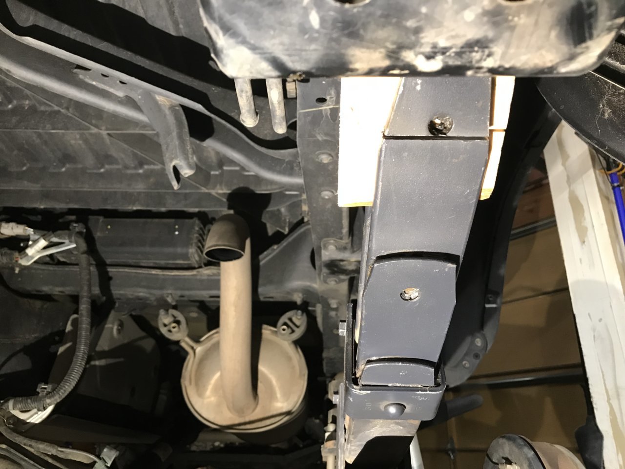

    I had that problem with the HH hanger shackles. Horrible noise but easy fix.A9F0980C-EE87-4135-99E5-FB4DC2EDC9CA.jpg
