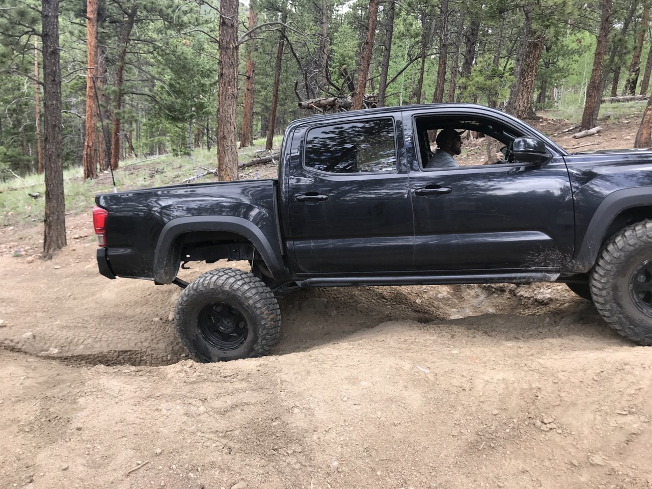

    What exactly did you do in this pic? :hattip:

    So the slamming in the rear causes you to roll forward?

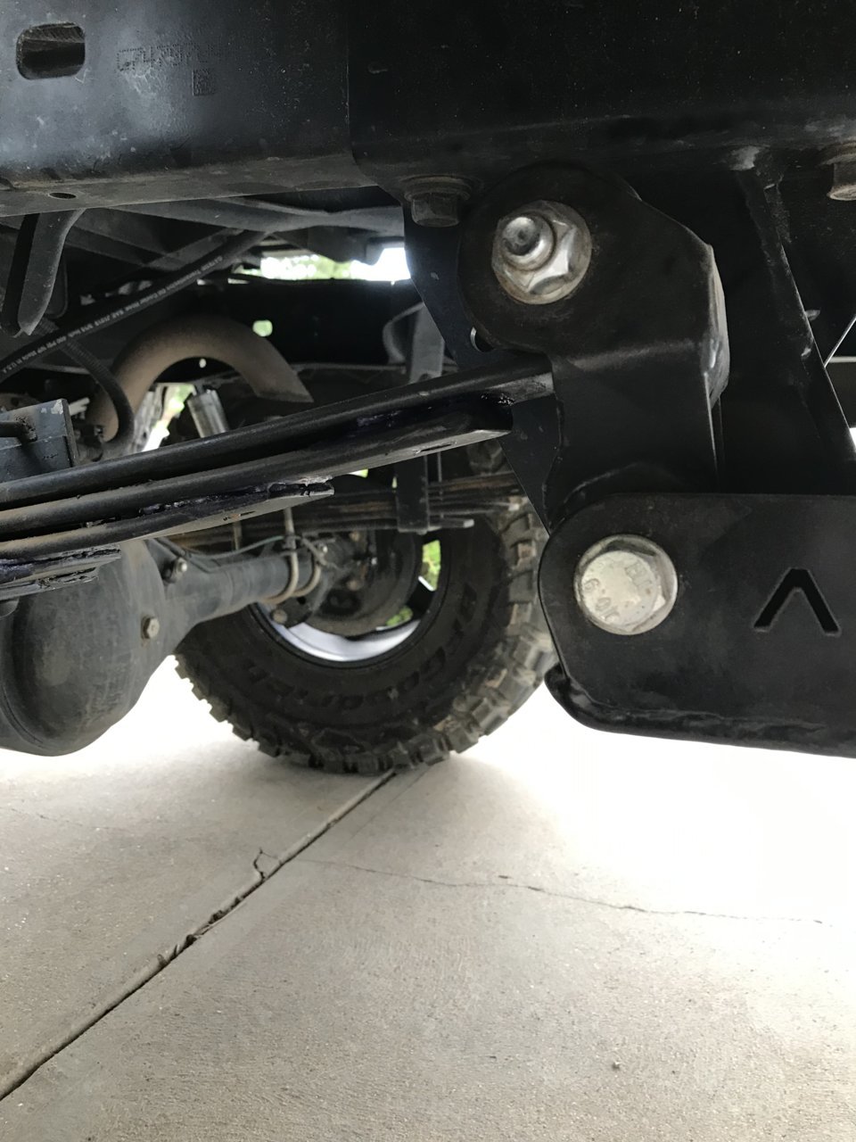

    Cut the end of the leaf off to fix this.2096018E-C29B-40BD-8505-9F36AF86F442.jpg

    WTF!?
    So that’s the damage I’m looking at or ?
    Are you saying you cut the end off by the friction pad?

    Correct and moved the friction pad back. 5AE0CD85-ADD7-4F5D-9D10-B9F0E4A05B5B.jpg

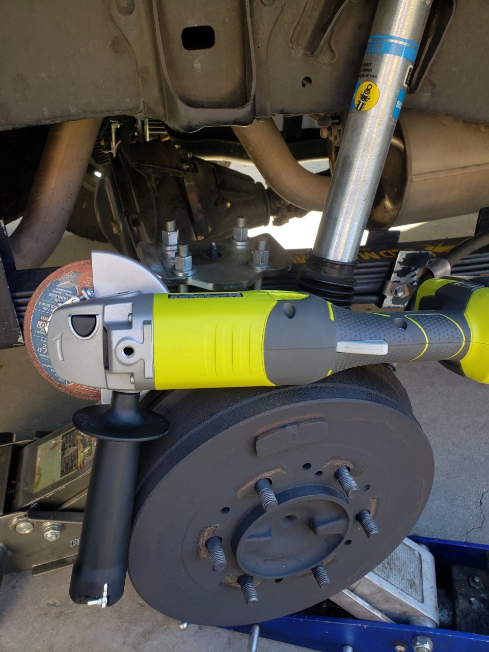

    Update

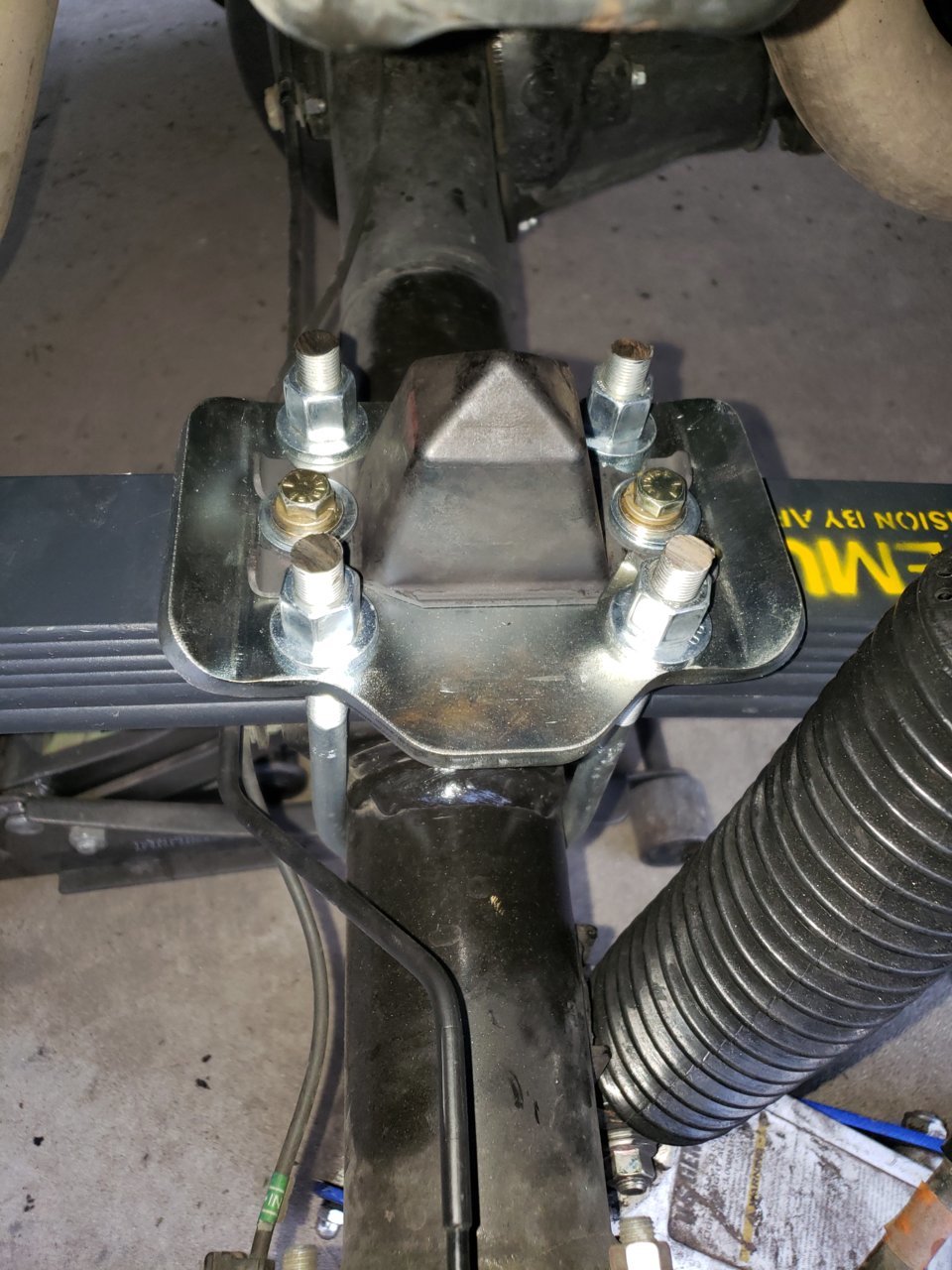

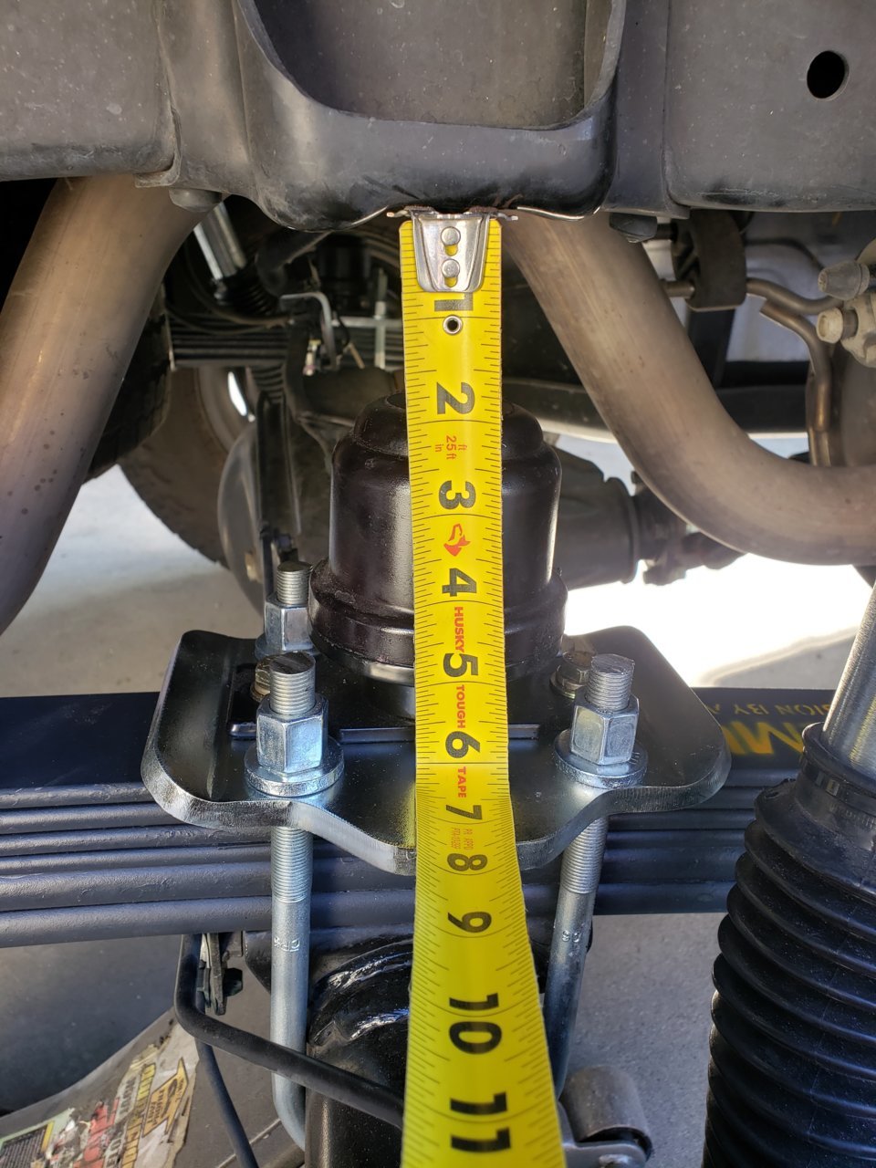

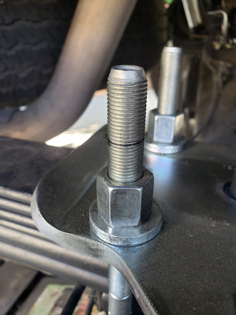

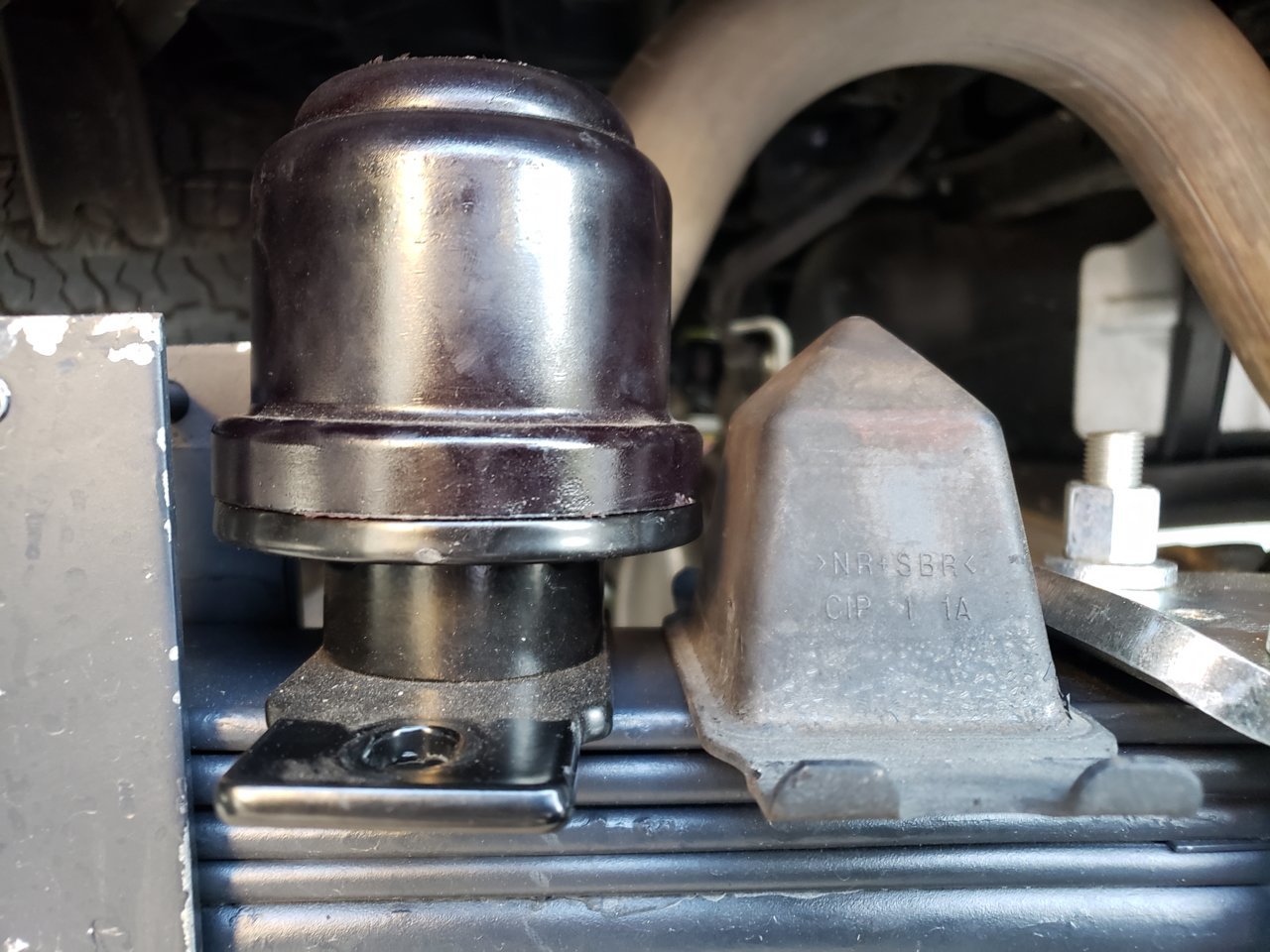

    Had some fun with the angle grinder today. Cut the u bolts shorter. Still bottoming out same as b4. 20190922_153938.jpg 20190922_154939.jpg 20190922_155751.jpg

    This may be annoying to do but I would swap the stock shackles, put the OEM u bolts on and run without that bump and see how it performs.

    LX470, 2025 Civic Si
    Update 2

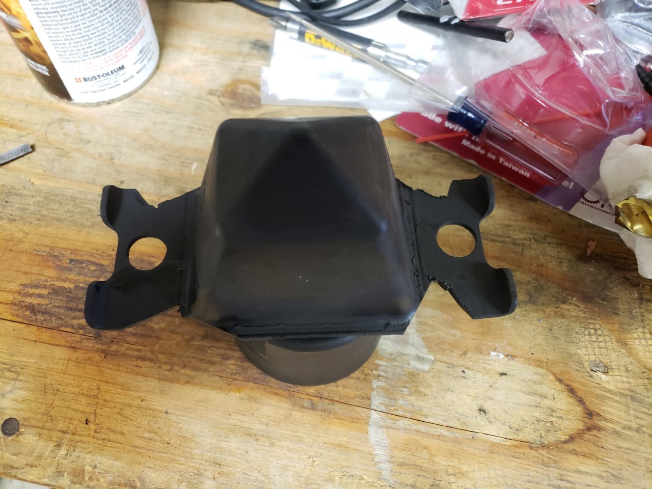

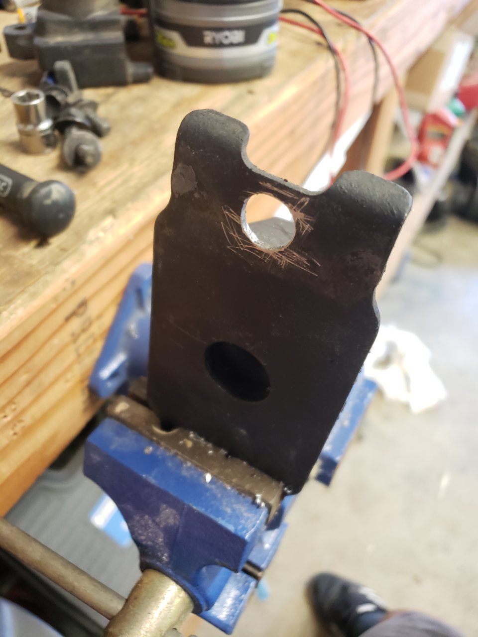

    Busted out the angle grinder and drill. Fabricated stock bumps to bolt onto u-bolt flip plate. Hack job but it was getting dark.
    Problem solved for me. Fixed my easy bottoming out. Stock bumpstops are 1.5 inches shorter.
    Thank you all for the help and ideas.
    20190923_175613.jpg 20190923_181203.jpg 20190923_195523.jpg 20190923_184604.jpg
