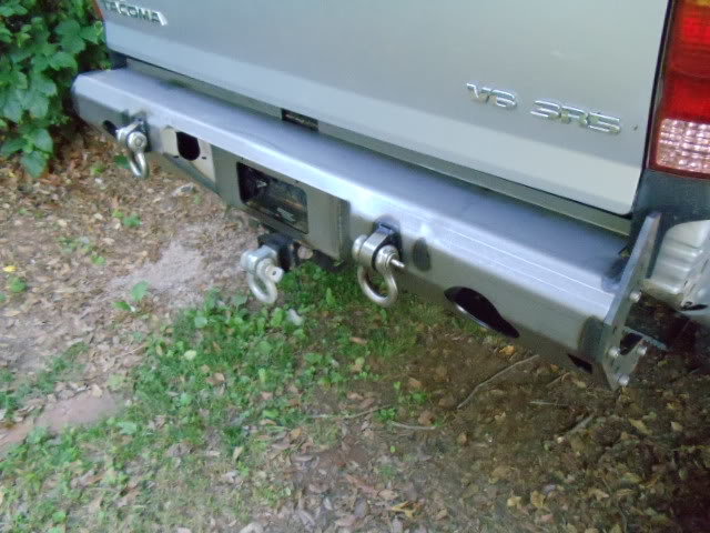

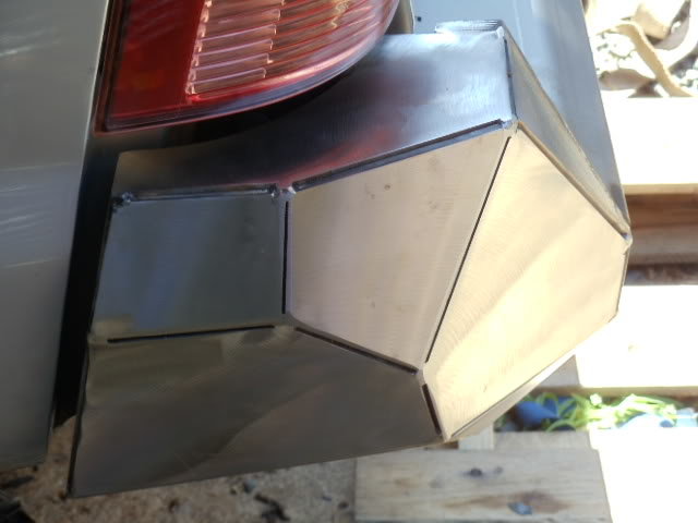

    That Bumper on the Blue truck is one Padgett Fabrication, LLC built over three years ago, and we are currently in the middle of a complete re-design on it. The new bumper, like the old one, does bolt to the Factory Receiver Hitch Assembly just like the Factory bumper. Its a complete bolt on unit, and nothing needs to be trimmed, drilled, or anything. The new bumper has been very expensive to build, and I really need to get some orders flowing to justify the re-design. The corners shown in the pictures below are the prototypes that were given to FabCon in Lynchburg, VA for production. The actual corners will look the same, but will be built from Lasercut and CNC bent parts and will have the same number of angles, but fewer welded seams. Thanks for the interest.
