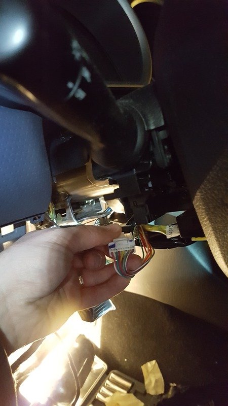

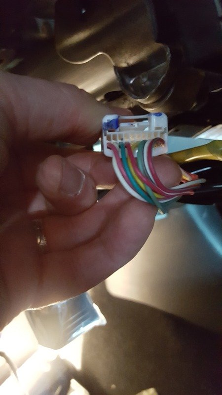

  15. Jan 16, 2017 at 8:52 AM
    Notoneiota
    Notoneiota [OP] Well-Known Member
    Aug 24, 2014
    #136871
    1,257
    Oakdale, MN
    14 Tacoma DCLB TRD Sport
    Mostly stock with a few minor mods.
    Pic of the plug immediately under the lights/turn signal stalk on the steering column.
    Closer picture:
    The directions say to connect the WHITE wire from the unit to the DARK GREEN wire (3rd from left) in this bundle. I did that and nothing happened (at least I didn't notice anything).
    I'm kind of wondering if it is necessary. If I'm reading things right, the WHITE wire just makes the driving lights flash to confirm it got the signal and is going to start. It already chirps the horn so I know it got the signal. And once it starts, all the lights come on so I can see it started. Anyone see a problem with me just leaving it disconnected? Seems to function fine. I just don't want anything to fritz out because it isn't getting a signal it thinks it should get or something.
