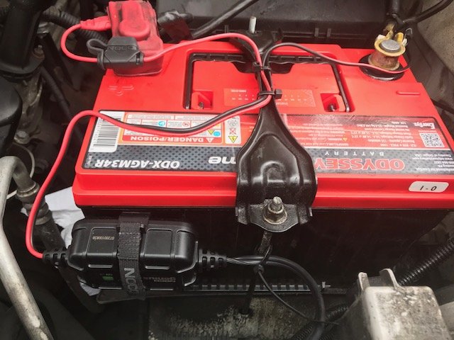

    If your good at a liitle modification you can fit a 34R. This is an AGM but you can find many regular ones. The liitle black box on the from is a 2amp maintainer since I can go weeks without doing any driving.
