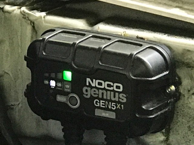

    I just modified the original mount. Used some generic battery J hooks and in went the 34R.
    Had a friend who stored their car over winter and gave them my 2 amp maintainer.
    Now have a inner fender mounted 5 amp that I use to keep the odyssey extreme fully charged.IMG_1748.jpg
