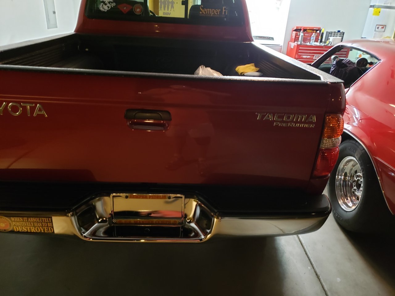

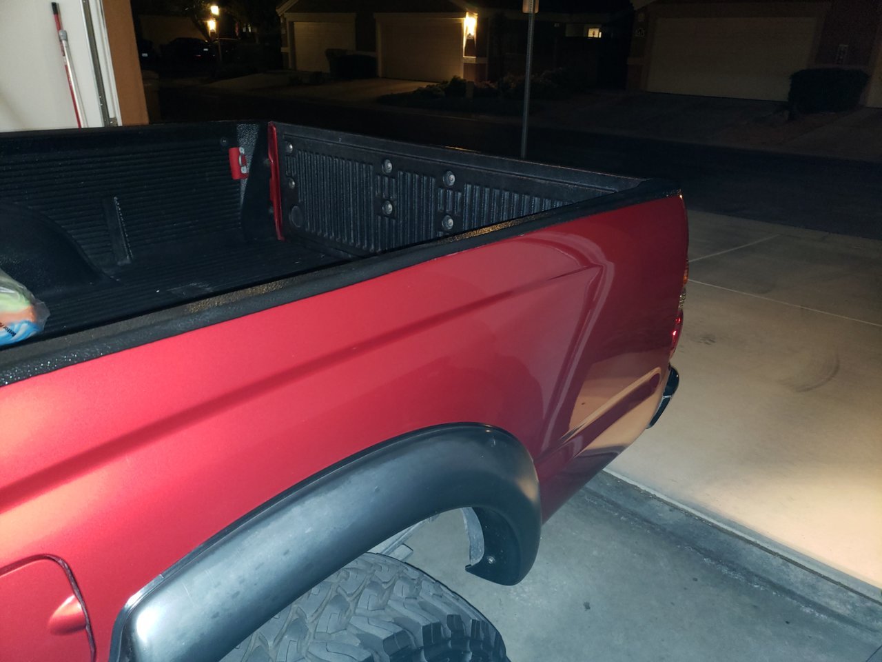

    Did some maintenance to my 1yr old ceramic coating a few weeks ago . Tried Mothers CMX , did 3 applications (coats) and this is the results !!

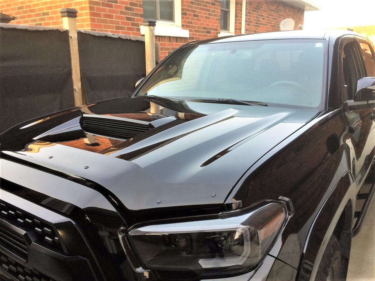

    daks
    daks Juzt for Shitz
    Jan 12, 2018
    #241060
    1,897
    Hammertown,Canada
    2017-TRD-Sport DCSB
    Ongoing
    You will need more than a clay bar. Don't talk to that guy again.
    Ceramics add so much gloss and depth to your paint that any scratches will become more obvious, only VERY micro scratches will be hidden. Even on a right off the delivery truck, white vehicle I would recommend a light polish. Will help the ceramic coating bond better too.
    It should be a fairly easy task to polish out a new truck yourself with a DA polisher. Buy a porter cable polisher kit that comes with the pads and you'll be glad you did.
    I polished out mine the first time to a mirror finish over a weekend when it was 6 months old. Then it took me a day to put 2 coats of CQuartz original on the truck.
    My maintenance was rinse off truck when needed. Hand wash with Carpro Reset once a month wipe dry with Carpro reload. That's it. Carpro recommends 3 months for reload but with this colour truck... nope this black shows everything.
    Very few micro scratches accumulated on the truck over a year, and on this truck you can see a fly fart from 20 paces.
    This year I'm going Gloss crazy, and have polished down the truck again with Carpro Essence then covered in 3 more coats of Carpro CQuartz 3.0 and one coat of Carpro Gliss then added Reload the next day.
    One thing exposed ceramic coatings don't like is Hard Water spots. So you want to add a "top coat" i.e. Reload to them. I added Gliss to my truck to make Reload optional but on this colour Black you HAVE to be paranoid. LOL
    Carpro CQuartz, GTech and any of the other major brands are all good.
    It's easier than you think to do it yourself. Comparable to sealing your truck.
    I'm even hearing good reviews on the 9H Mr Fix stuff that is going for $10 a bottle.
    (never apply in sunlight, outside on a nice day in the shade is fine, I find that 15degC to 22deg C (60-75F) are the sweet spots for easiest temps for coatings. 25+ deg c and you have to do smaller areas so the coating does not dry too much before buffing.
    At 15deg C on Sunday I could do 1/2 of a door/panel in one pass with the CQuatz UK 3.0, not just the 2x2 area that they recommend. Gliss flashes too fast so you have to keep it in a 2x2 area or less if it gets warmer or windier out.
