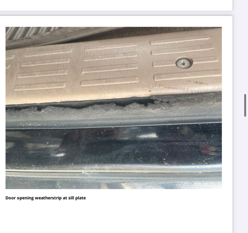

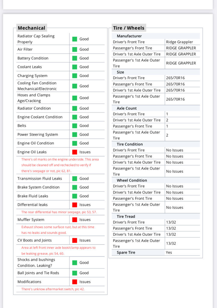

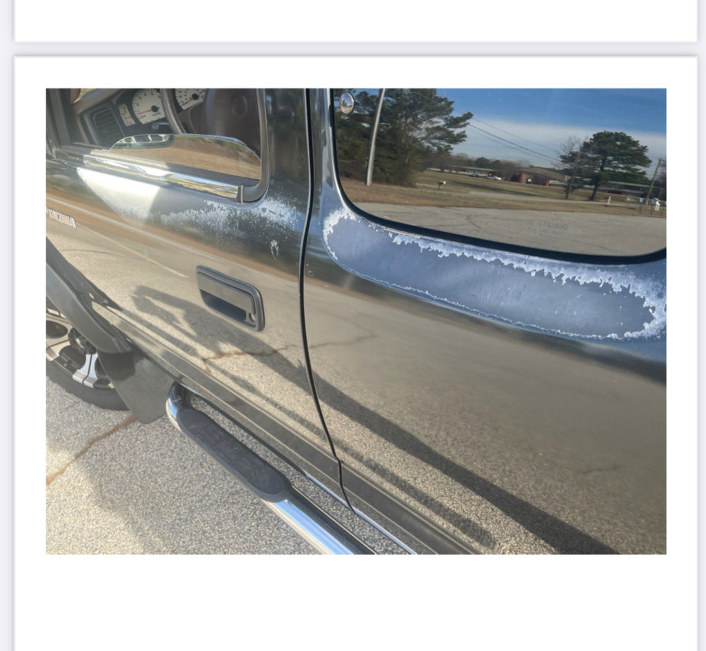

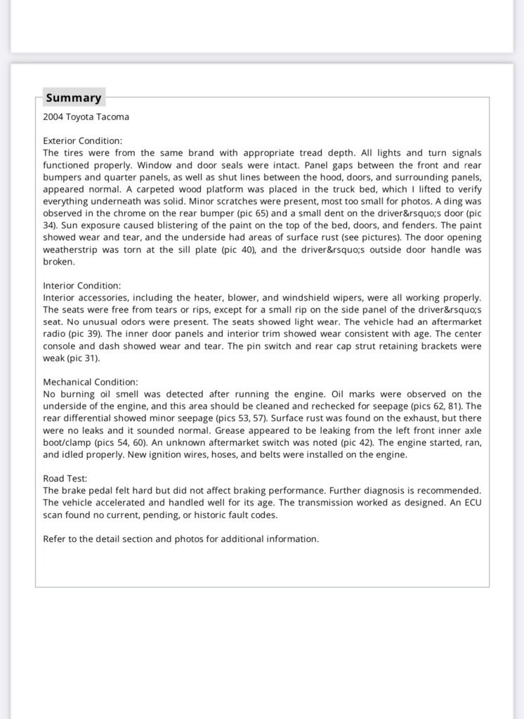

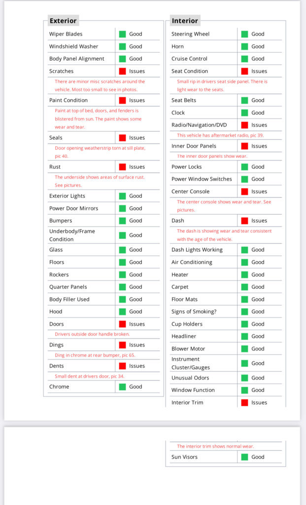

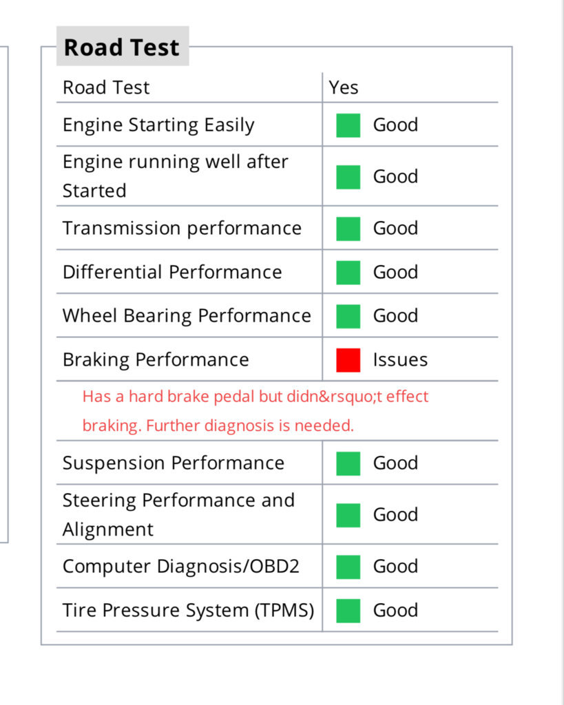

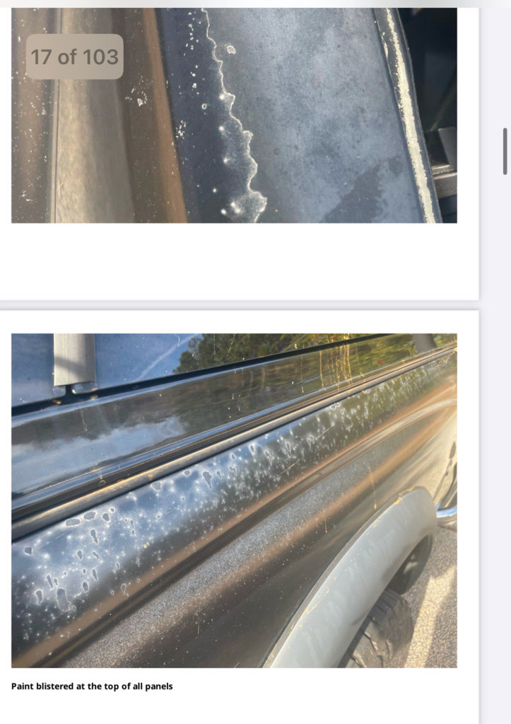

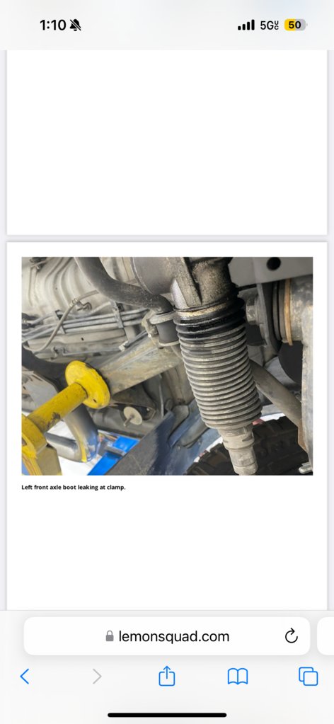

    What do ye think here? Have some bargaining and small concerns for sure.

    The clear coat fail is common. Up to you how much you care. My '00 had it when I bought it in 2010 and it's probably doubled in extent in 15 years. But the paint holds and it doesnt' rust.
    That steering rack leak is a strong point for negotiation. I just had mine done --- cost $2k (!) but there were additional issues. It's a $600 part and most of a day in the shop. It's not urgent, but watch the PS fluid.
    I'd want that rubber fixed. And the trim plates under the windows. Would drive me nuts.
    I think there is a lot of negotiation room here considering the "weathering." But If you go there intent to drive it home they sort of have you captive and you lose some bargain power. I'd look at BringATrailer for some comps. Make sure to note pre-runner over 4WD.

    Paint is trash. Are some colors and years prone to worse clear coat failure? I'm not paying top dollar for that! You can replace all the mechanical stuff on your time and less dime if you do it yourself but once you get into making the exterior look good your talking down time and big bucks. Don't fall in love with every truck you look at. Use your head make good decisions based on facts you'll be happier in the long run.

    I walked away from this one. Offered them $9500 given everything said and all of the concerns, leaks, paint deterioration, 2WD etc etc.
    They were firm on the $13000 asking price and unwilling to budge. So I’ve passed on it.
