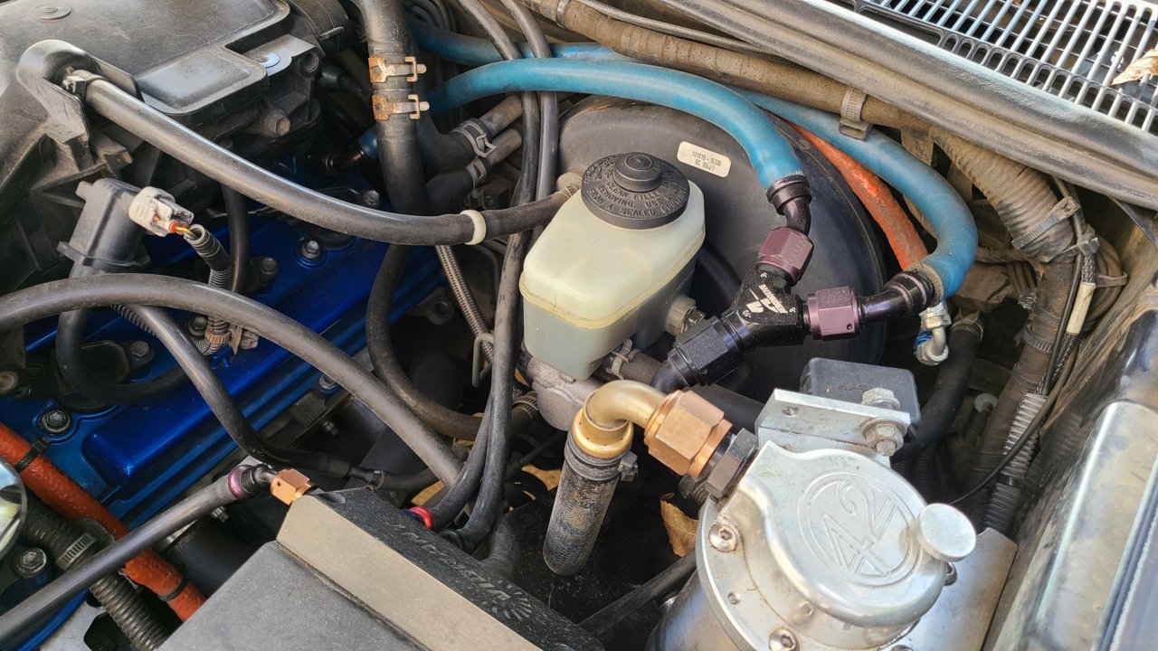

    Question: I was doing a boost leak test tonight and have air getting past the turbo seal and gurgling in the oil pan. Would this be different if the turbo had oil pressure? Is there any hope that this would be a normal finding in a truck that hasn't run in a while?

    Hello mate. The first thing needed to help you overcome these potential issues, are pictures of your engine bay. That way we can see what is going on with your vacuum routing. Please please please take some pictures.

    Right! Sorry! The boost leak test apparatus is still hooked up, so there is a tee open in the pic, but that would be connected to the vacuum line from the turbo. From left to right on the vacuum block is: BOV, EBC, cruise(?), fuel pressure reg, and wastegate. The driver's side valve cover still has the PCV going to the manifold, but its a brand new PCV. Just haven't gotten around to blocking it off and doing the catch can like yours.[​IMG]

    Here is your vacuum leak right here. Where the filter is on your catch can. The reason being is because the driver side valve cover is still connected to the plastic upper plenum. Under idle and cruising the engine is sucking in air from that catch can breather.

    Here is a quick test @MrMurse .
    Disconnect the hose from the driver side valve cover, specifically where it connects to the intake. Cap the intake port. Test drive.
    Ultimately, that driver side valve cover needs to be routed to the catch can as well.

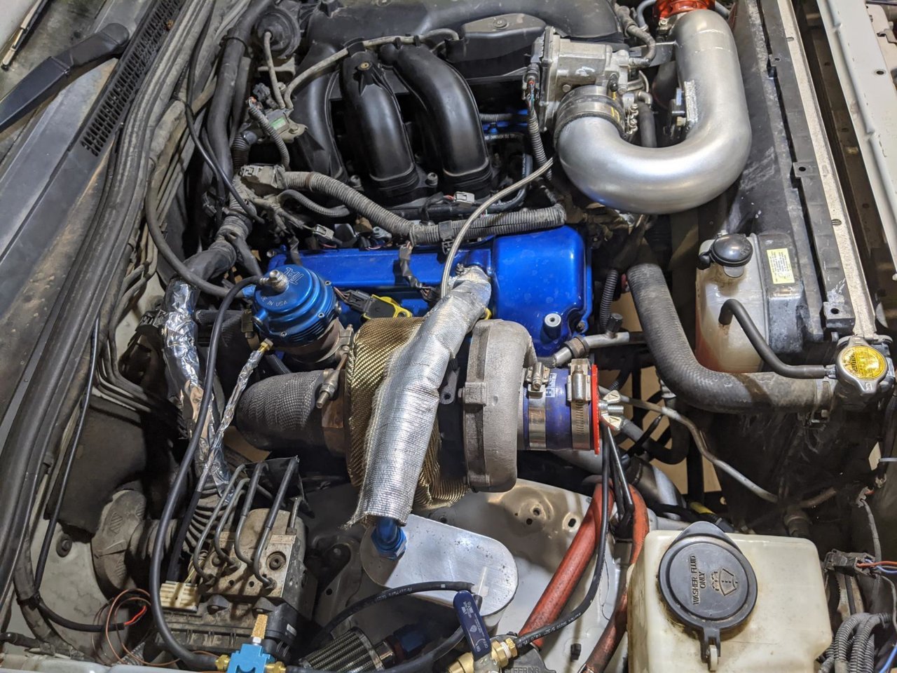

    Torspd Custom Turbo kit [] Borg Warner 9180EFR Turbo [] Haltech Elite 2500 [] TiAL Q BOV [] TiAL V44 Wastegate @ 15psi [] CP Pistons [] CP Carrillo Rods [] ARP Head studs [] ARP Main Studs [] ARP Header - Head Studs [] Ported Heads w/ 1mm oversized valves intake/exhaust [] Brian Crower Forged Stroker Crank [] Darton M.I.D. Sleeved Block [] Kelford Camshafts [] Torspd 160* T-stat mod [] APR Large Fuel Rail [] Walbro 460 LPH E85 Fuel Pump [] FueLab FPR [] APR T56 Conversion Kit [] KP RACING Built T56 [] McLeod Racing Custom Twin Disk Clutch [] One Piece Aluminum Driveshaft [] MGW Shifter [] Custom lowering kit [] Ohlins Front Coilovers [] QA1rear shocks [] Custom Ron Davis Radiator [] Dual SPAL Electric Fans []
    Here is mine as an example.

    Awesome. Think that explains the gurgling in my oil pan, or is my turbo seal blown?

    It very likely does.

    It went well! The only place leaking air is the MAF, which I'll be fixing. That being said, the original tuning problem still exists where the ST and LT fuel tables are pulling fuel, but the actual lambda values are much leaner than the commanded value.
