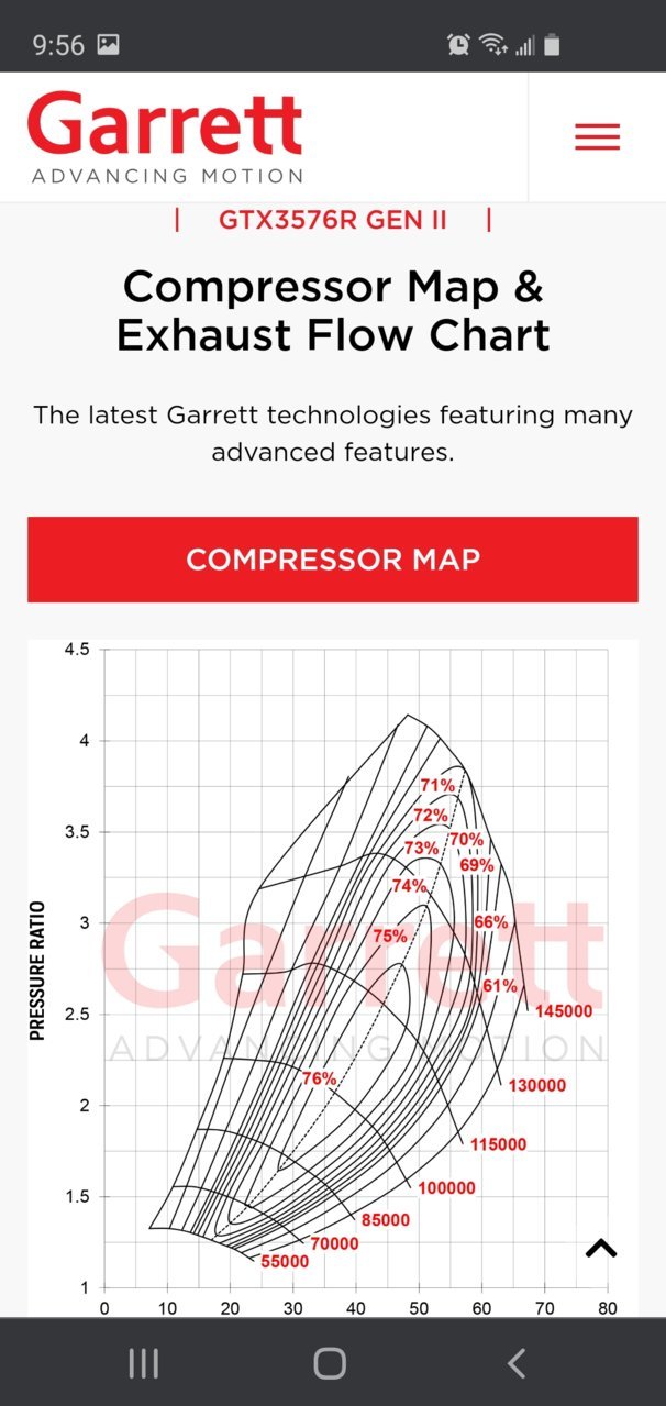

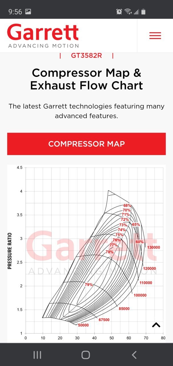

    I think you could save some coin and go with the Gt3582r and get the results you want.
    Check out the compressor maps between Gt3582 and Gtx3576.

    They are remarkably similar. I hemmed and hawed over those two and the gen 2 version of the 3582. I just wasn't sure if the 3582 was overkill for my build or not. I haven't pulled the trigger yet, so I guess more research is in order tomorrow. I guess I could look at the gen 1 version of the 3576 too.

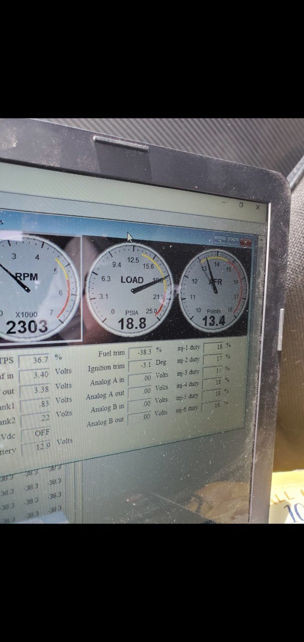

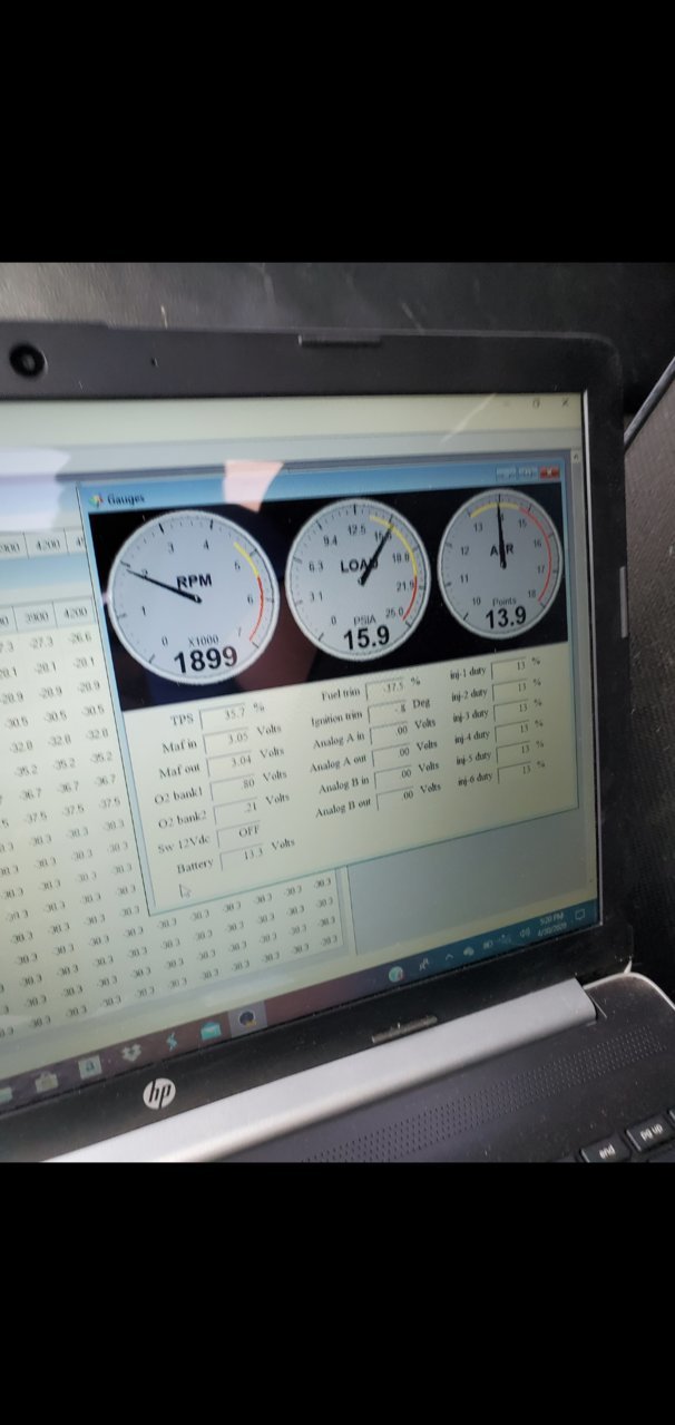

    Here are a couple screen grabs showing part throttle response.
    4th gear (auto on the freeway)
    ~ 35% throttle
    Pressure measured in absolute, so 14psi is local atmospheric, anything above this is boost.
    You can see ~2 psi at 1900
    ~5 psi at 2300
    These are crude obviously, keeping my eye on the road and just pointing the camera at the screen, some variation in results, but gives you an idea on response, again around 1/3 throttle. Also I've added a more effective intercooler since then (Garrett also).Screenshot_20210127-221536_Gallery.jpg Screenshot_20210127-221704_Gallery.jpg
    Torspd and MrMurse[OP] like this.
