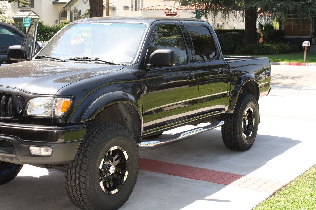

    my setup is bilstein 5100's paired with eibach 3" lift springs from toytec and a 2" AAL. depending on your budget get new leaf pack, an AAL will re arch them but not permanently.
    how my truck sits: TheTACO008-1_4a7e46db65ea512169807a6a6ad44f18bba2328f.jpg
