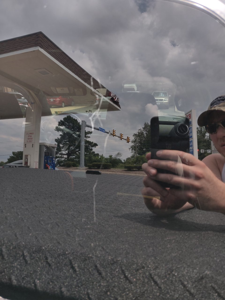

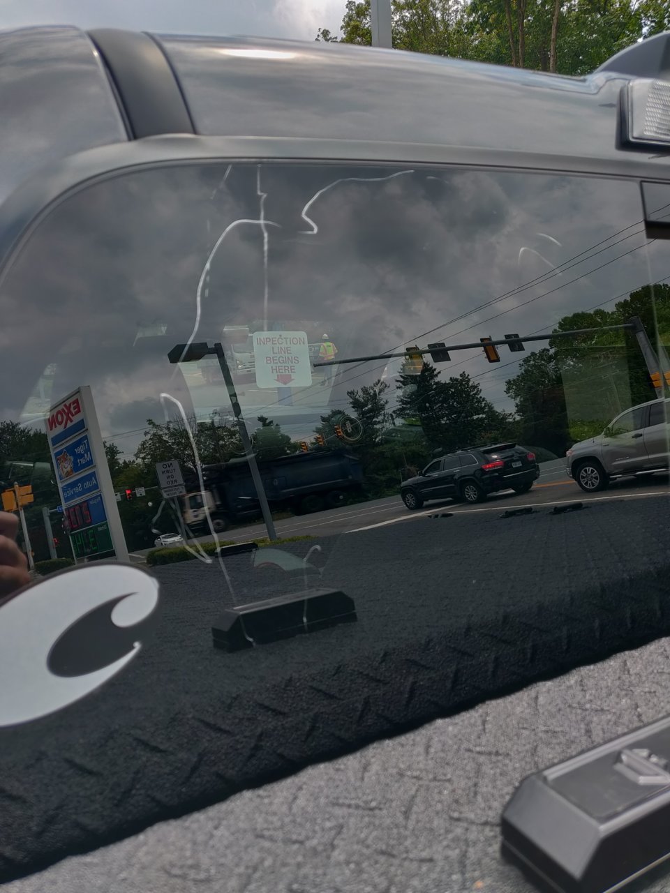

    To make a long story short, I scratched up my factory reset tint pretty bad while putting my diamondback bin back in in the dark. Anyone know if this can be fixed or is my only option to replace the entire back window? I talked to a tint shop and he said the factory tint is fused in and therefore theres not a fix...any help would be appreciated!

    I would think tint shop guy would know best. That is F'd up bad, sorry man.

    Try removing the scratches with glass polishing compound (cerium oxide). If you’re not comfortable doing it yourself, try an auto glass repair shop or body shop.

    Sure it can be fixed replace it and move on any half ass repair would be visible and a reminder.

    Kind of redneck rigging, but if it's all ready FUBAR, you have nothing else to loose. Try a nice fresh Sharpie, it'll wear off, but Sharpies are cheap until you save up for a replacement window.

    Maybe spray some aerosol tail light tint into a small container then use a small brush to fill in the scratches

    Polish all the tint off. That's almost free.

    It's privacy glass. There is no film on it. The glass is manufactured with the grey tinting in it.

    Then jeweler's rouge, a couple of hours, and a few dozen Dremel polishing pads will fix it. If they aren't deep, a few minutes might be enough.
    There will be minor distortion where you polished it, but how much time do you spend checking parallel lines through your back window?

    I agree, buffing will probably be the best bet other than replacing it. It won't disappear completely, but it will surely look better... but randomly seeing it thru the back glass would aggravate the shit out of me. I'd end up replacing it for my own piece of mind, lol.

    You're not going to buff that out, or get it anywhere near looking acceptable. You can try a sharpie to hide it for a while, but replacing it is really your only option.
