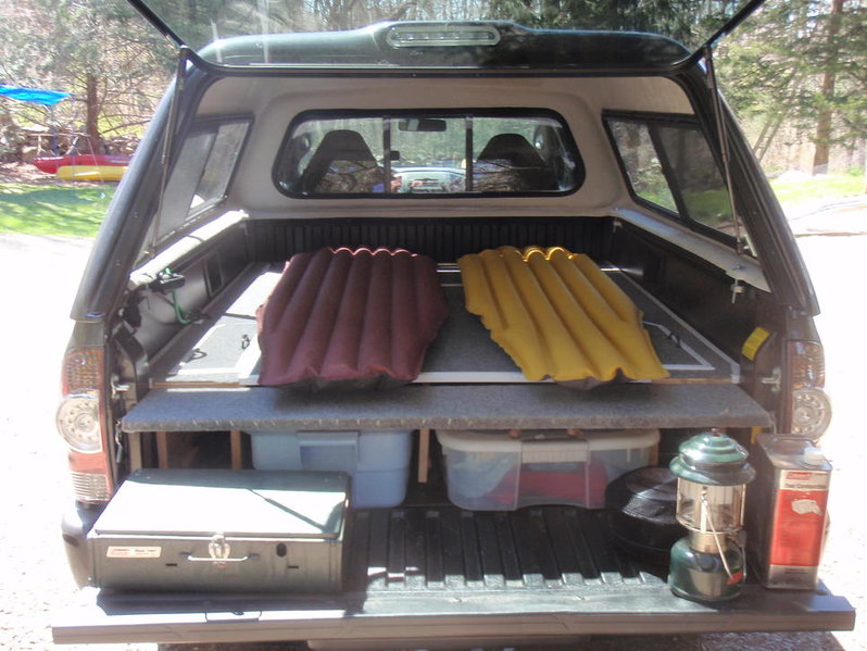

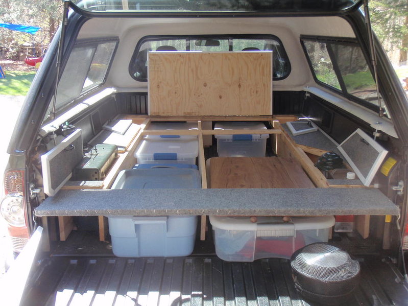

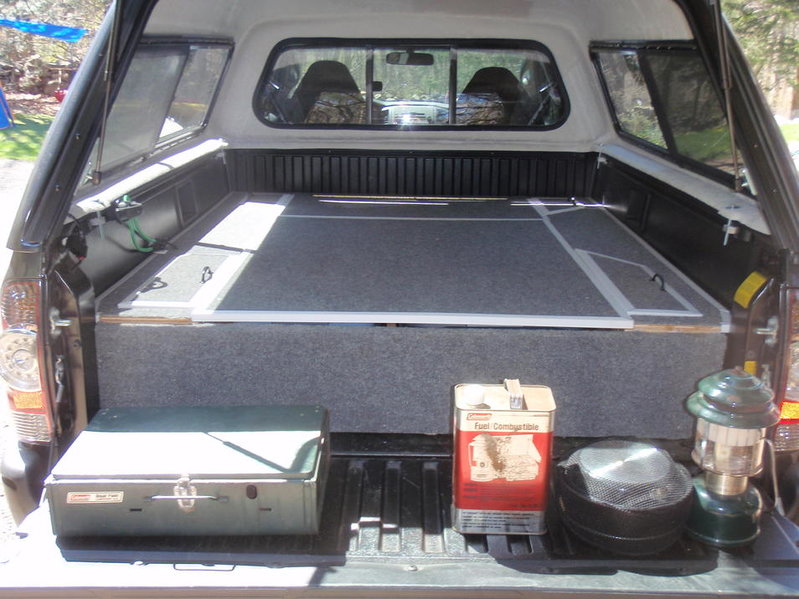

    a platform with a Leer cap

    Your Platform is sweet MSCOFF. If you are sitting on it with your legs crossed "Indian style" can you sit full erect?

    i put a cot in my ARE, and i couldnt sit indian style..erec..hmm, "upright". erect was a-okay. hahah.

    this is the way to go, my friend has the same setup and it is AWESOME.
    He has straps tied to the containers pushed towards the cap so he can pull them out easily, fits a ton of stuff in there...

    i would love to get some plans for that platform.. i was looking at building something very similar to that.

    the Leer cap I have is the 180 model. 25" height from bed rail to the top. The platform rests on the ridge in the composite body. 8" from top of plaform to top of bed. So a total height of 33". I'm 6'6" so it's a bit tight for me sitting up. But I didn't want something like the Leer 122.
