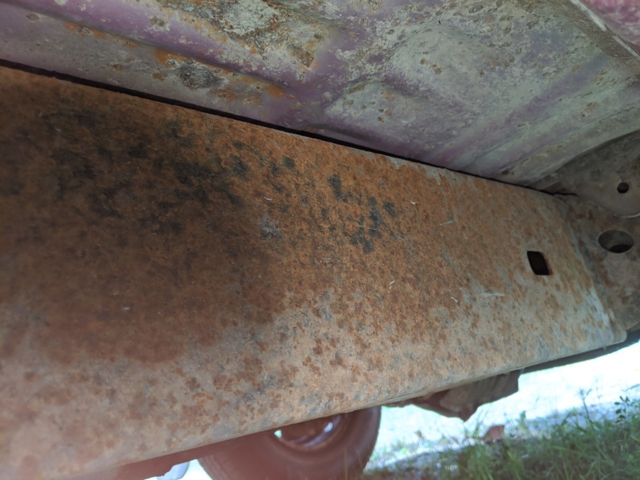

    Deeman
    Deeman [OP] Well-Known Member
    Jun 26, 2020
    #332584
    50
    Columbus, Ohio
    2003 Toyota Tacoma RWD Base Model 5 Lug
    Nerf bars and topper
    Also, went back under to get more pics. It's interesting that the frame section facing the exterior looks to be just fine. It's like this on both driver and passenger side where the major damage is. I see that the inner frame is nested into the outer frame (shown here) vs. being a single box frame. Like two c-channels nested to make a square box frame.
