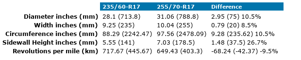

    from the online tire size calculator
    Do you plan to regear? Your truck will be alot slower with that size
