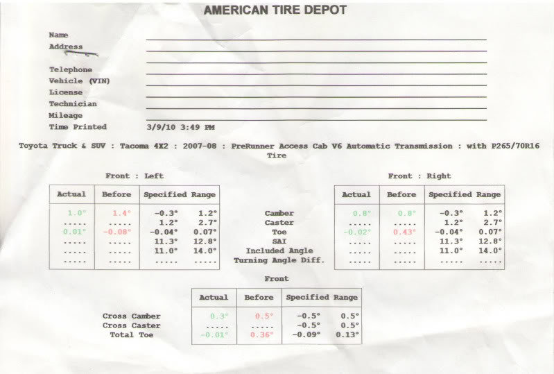

    Also wondering why there are no numbers for caster, SAI or Included Angle on my sheet...
