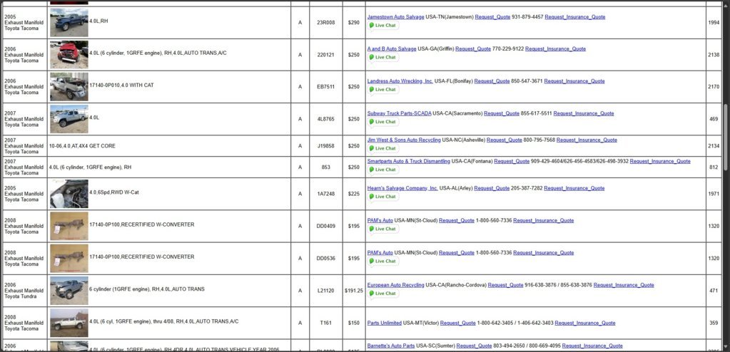

    The great thing about vehicles with long production runs like this one, is that Toyota made a bazillion of these trucks so the aftermarket support is great and the used parts resources are even better. I'd find some Grade A used exhaust manifolds off of an 05-11 Tacoma (car-part.com, LKQ online, ebay or support one of your local wreckers-they often have the best customer service) and knock out the install myself. Even with new manifold and exhaust pipe gaskets, new name brand replacement hardware and a boat load of consumables (PENATRATOR!), you'd be in and out the door for under $1000.
