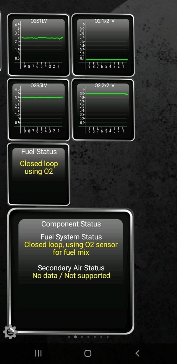

    Yeah, I'm going pick up one of those fuel pressure gauges tomorrow. But on the way home, I took a screenshot of the sensor outputs, as read by the ECU and my phone. This was idling at a red light. Bank one at the top looked alright. But bank two, both sensor 1 and 2, reading high consistently, both pointing towards exhaust leak or lack of fuel to some degree. Or that's how I am reading the FSM.

    I am having almost the exact same problems right now. I pulled 20% fuel from LTFT and still showed rich bank 2. I thought I had leaky injectors so I purchased new ones. After installation and another tune, for the injectors, I started running lean bank 1 rich bank 2. I’ve also changed the ecu, up and downstream 02 sensors, and MAF sensor. Still haven’t figured out what’s going on and it is back in the shop. I’ll update this tread whenever I get any info.

    Maybe your tps? Cant think of anything else since it seems like you have checked everything.
