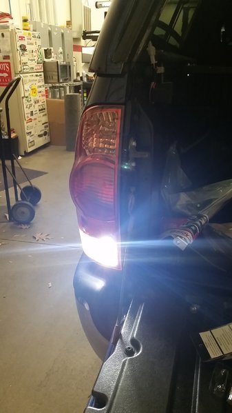

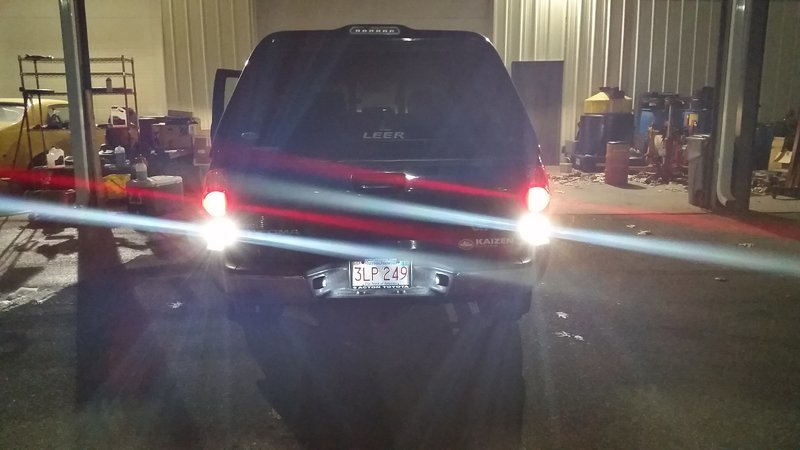

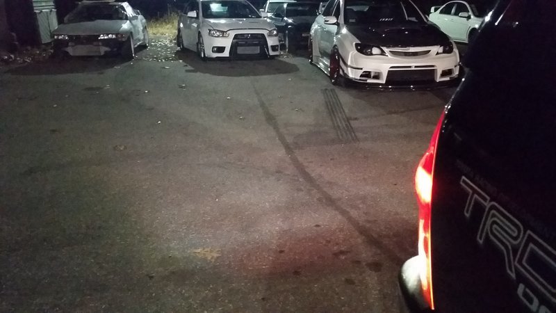

    I'll try to grab some of it lighting up my driveway in a second. These were from Nov 16th 2015 when I installed them.
    LED
    OEM
    Both LED
    Lighting up the shop lot

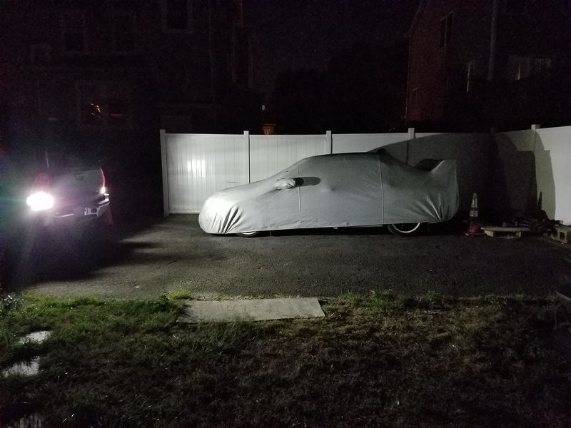

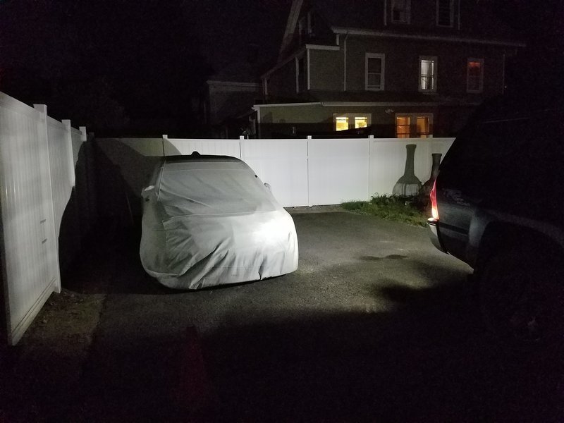

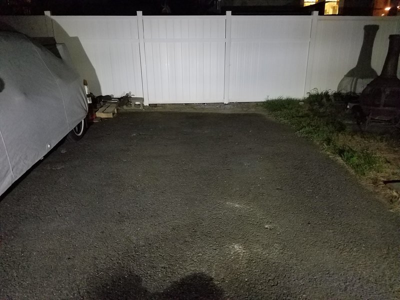

    Just taken in my backyard. My evo is under the car cover for size reference. It's bright enough that I can actually see out of the 3 layers of tinted windows from the cab, and Leer cap.
