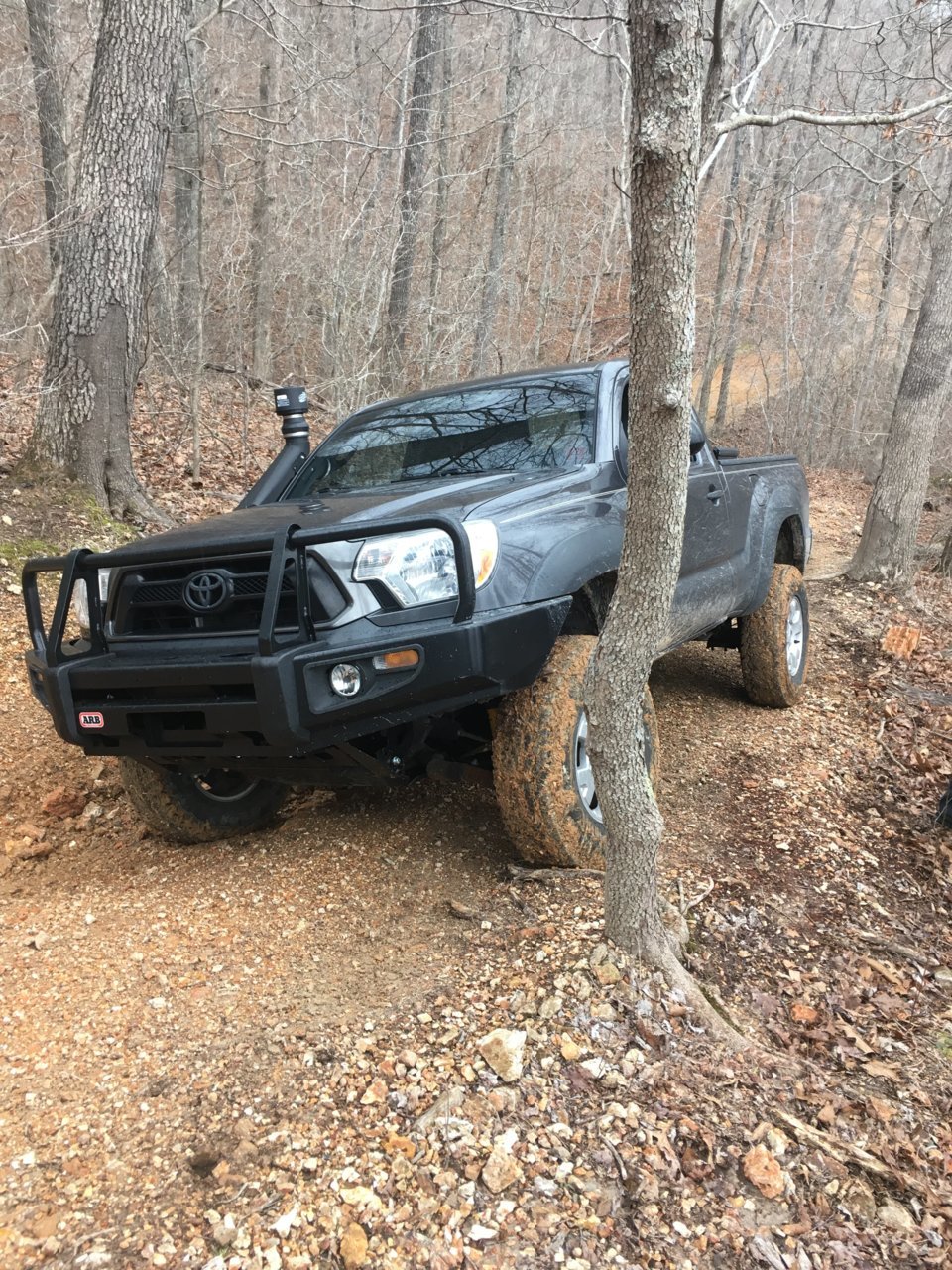

    OME 884’s ,Dakar hd’s, Jba uca, lce header, 4.88’s, Arb locker , j shift tcase-T4R, arb bumper, leer topper, 3500w inverter, mad wife, scratched paint, skid plates, snorkelerer, led flush mount reverse lights, etc..
    OP do NOT run 886’s if you have a regular cab unless you love changing cv boots. I have an arb bumper, steel ifs skid, and lca skies with 884’s and I’m right at 2” of lift. Run 885’s max on a single cab.
    I ran 886’s at first on my truck and immediately swapped them out. I had like over 4” of lift and it felt like riding on bricks... with all my weight.
    I was that guy that goofed. I went through your exact scenario and made the wrong choice. Seriously don’t put 886’s on a single cab.
