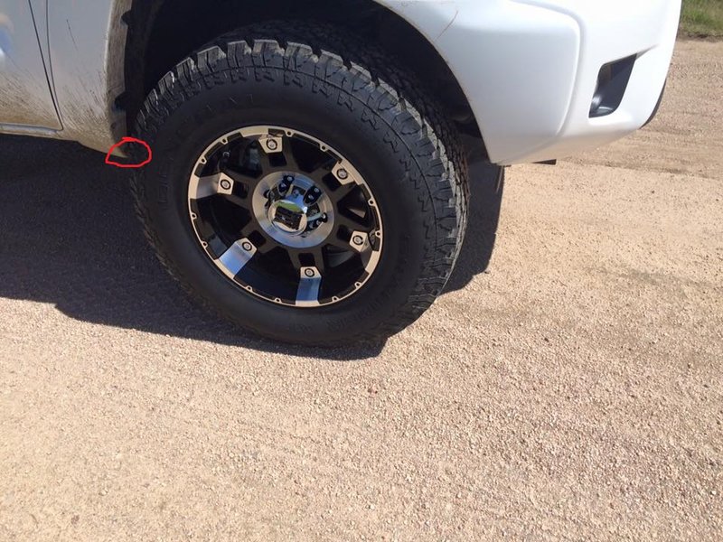

    I actually have done that already and it's a very small portion of the fender flair that it's hitting, but still when making those turns it's very noticable and well to be honest embarrassing haha. I'm at work right now, and I don't have a good picture....but the highlighted area is the bottom of the fender flair that I'm referring to (but the portion inside the wheel well).

    I wonder what your caster is set as at stock suspension. I bet a good alignment with caster setting at 2.5 would remedy your problem. You can always just get an alignment inspection as its free in most good shop just to see where you caster setting is at. I believe max stock setting can be pushed to 2.7 for caster. Just make sure your camber remains at zero. This should get rid of the rubbing problem without cutting anything. You should be able to fit stock tire size even with those wheels. I believe backspace in that size is about 4.5" which pushes your wheel/tire out.

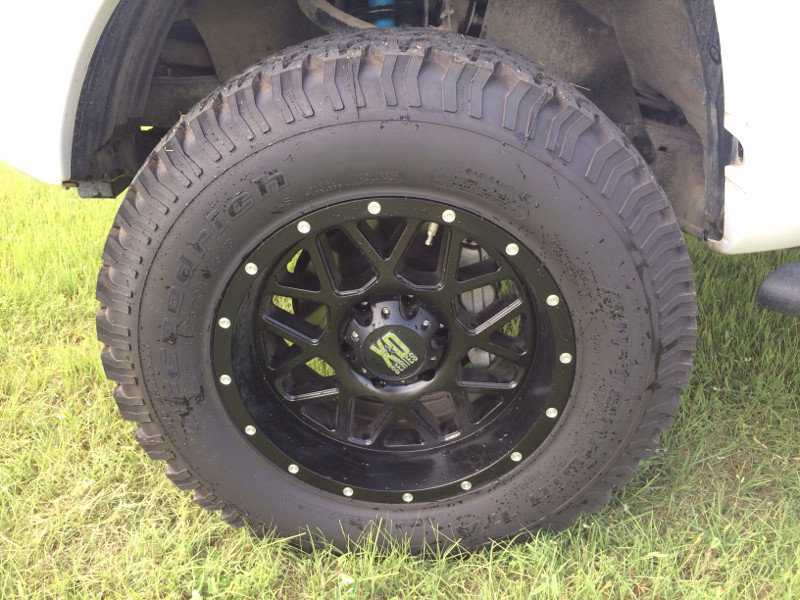

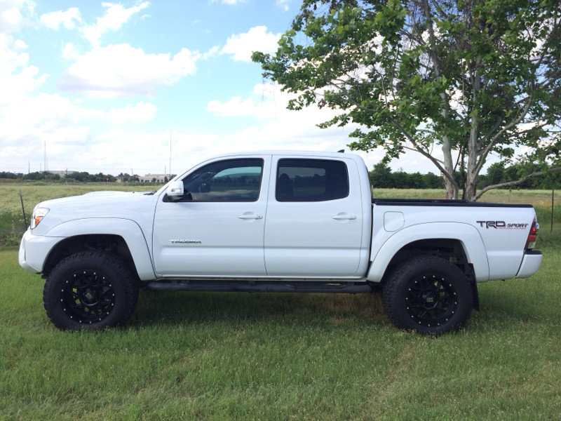

    Strut Spacer and block lift, w/33" tires on custom wheels.
    I agree about the alignment, to some degree. My truck was already lifted and had bigger tires and wheels. With the mud flaps off, I got pretty bad rubbing and obnoxious noise. The dealer had the alignment done, but wasn't right. He had it re-done, and now I have almost no rubbing now and the noise is slight or non-existent.
    When my alignment was done, they installed bigger cams from toyota, so the caster and camber could be set to factory, which has more positive camber than the zero recommendation. When lifting an IFS truck, without relocating A-arms, it affects the amount of camber adjustment, and having zero positive camber will work, but affects SAI. You never want to go negative on camber, unless maybe in a racing application, but not highway use. Too much or too little camber affects tire wear. If lifted and bigger cams aren't used, then I'd recommend as close to factory spec on caster, without going negative on camber.

    Factory caster is as low as +1 which would not help in this situation rubbing on the back (cab mount area). This is why caster should be pushed to max setting while keeping camber at 0. I've never heard of this "bigger cams" thing. Do you have a part number on your work order?

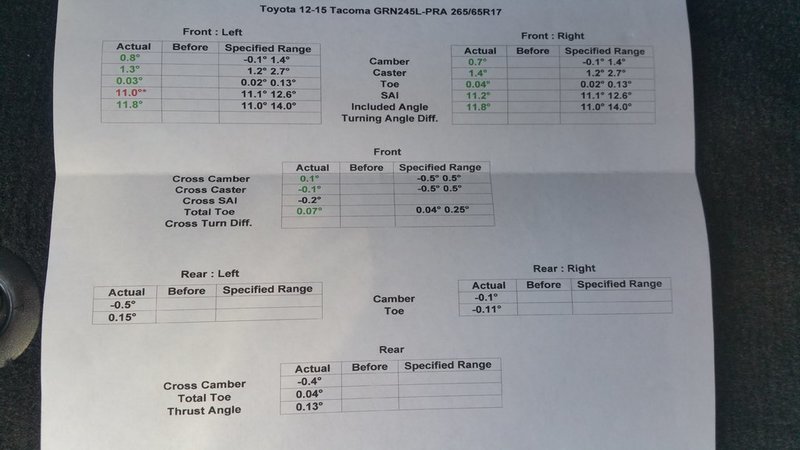

    Correction and my apologies. I couldn't find the part number on the alignment invoice, so I called the shop. The guy said it was only the stock bolt, and was replaced because the cam was stripped on the bolt and wouldn't turn. I was surprised and maybe misunderstood, when told that it was different bolt than stock.
    Here are the alignment settings. I agree more caster would be good, and since the adjustment is on the lower arm, it should help with rubbing. Forgive my first try at attaching an image, we'll see how it goes. Second try, had to rotate the image.

    No need for apologies. I was merely intrigued by a bigger cam bolt as an option. How tall are your spacers? I'm assuming you have at least 2"+ spacer lift to run 33's.
  13. Jul 21, 2015 at 9:57 AM
    DriverSound
    DriverSound Señor Member
    Mar 29, 2009
    #15329
    5,851
    Oregon
    2015 DCSB OR 4x4
    Too few to list.
    Increasing caster pushes your wheel towards the front to prevent the rubbing in the back. The trick is doing that while keeping camber at zero. I actually had to do my own alignment to get the setting to where I wanted it. I also had aftermarket UCA so that made it easy but when my lift was under 2", there was no rubbing with 265/70/17 with aftermarket wheels (4.5" back space) due to setting the caster at 2.2.

    A 1.5" spacer would give you about a 3" lift in the front which allows for the 33's. The caster is on the low side for a lifted truck but within oem specs. Does it feel like it wanders on the hwy?
