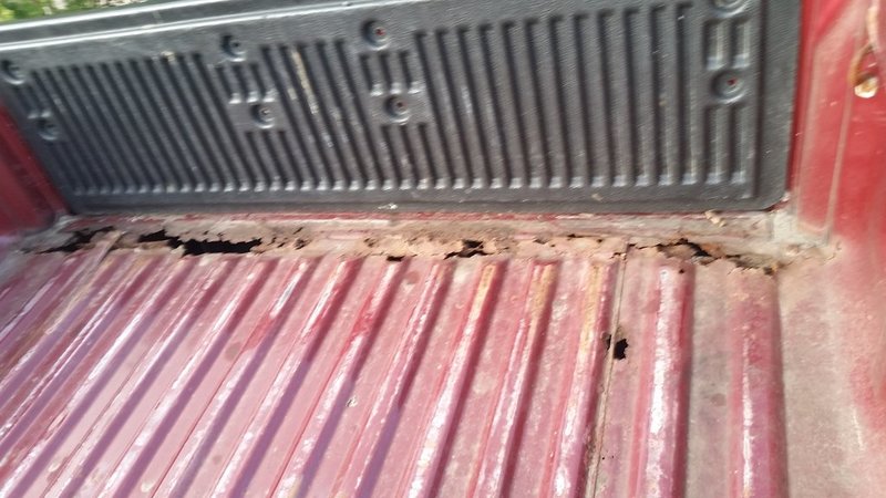

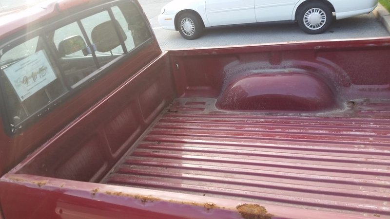

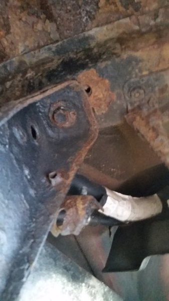

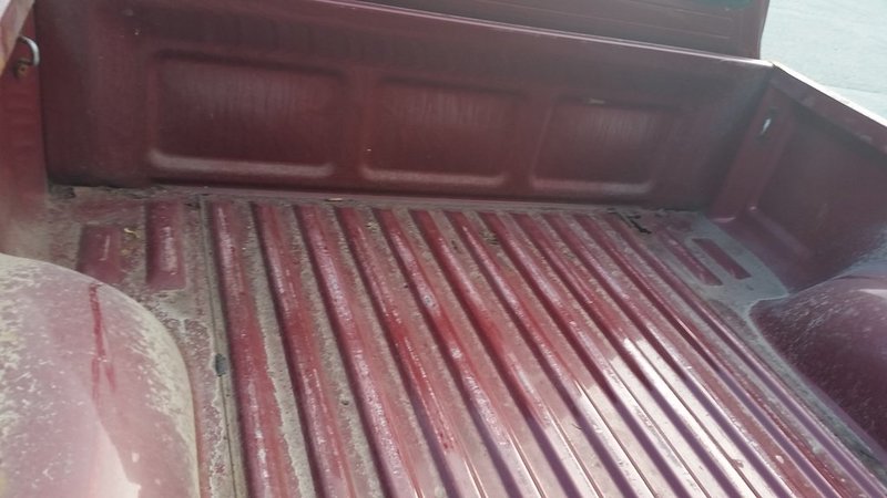

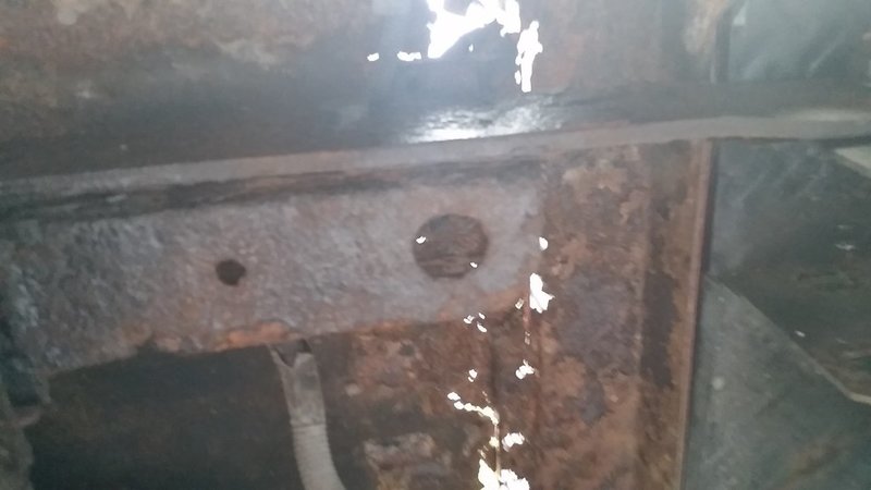

    So here is my bed. Is there any way to buy bed bottom somewhere? My could cut out rust and weld in patches....has anyone tried this before?
    Photo of one of mount below as well.
