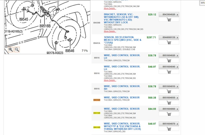

    so i finally got a chance to get under there and the right rear speed sensor wire has a nice gash in it right through one of the wires. I see there are 3 part numbers listed for this so how do i know which one i need? I have an 09 ACLB TRD MTX

    I'd ask a dealer to run your VIN and tell you which part number is needed
