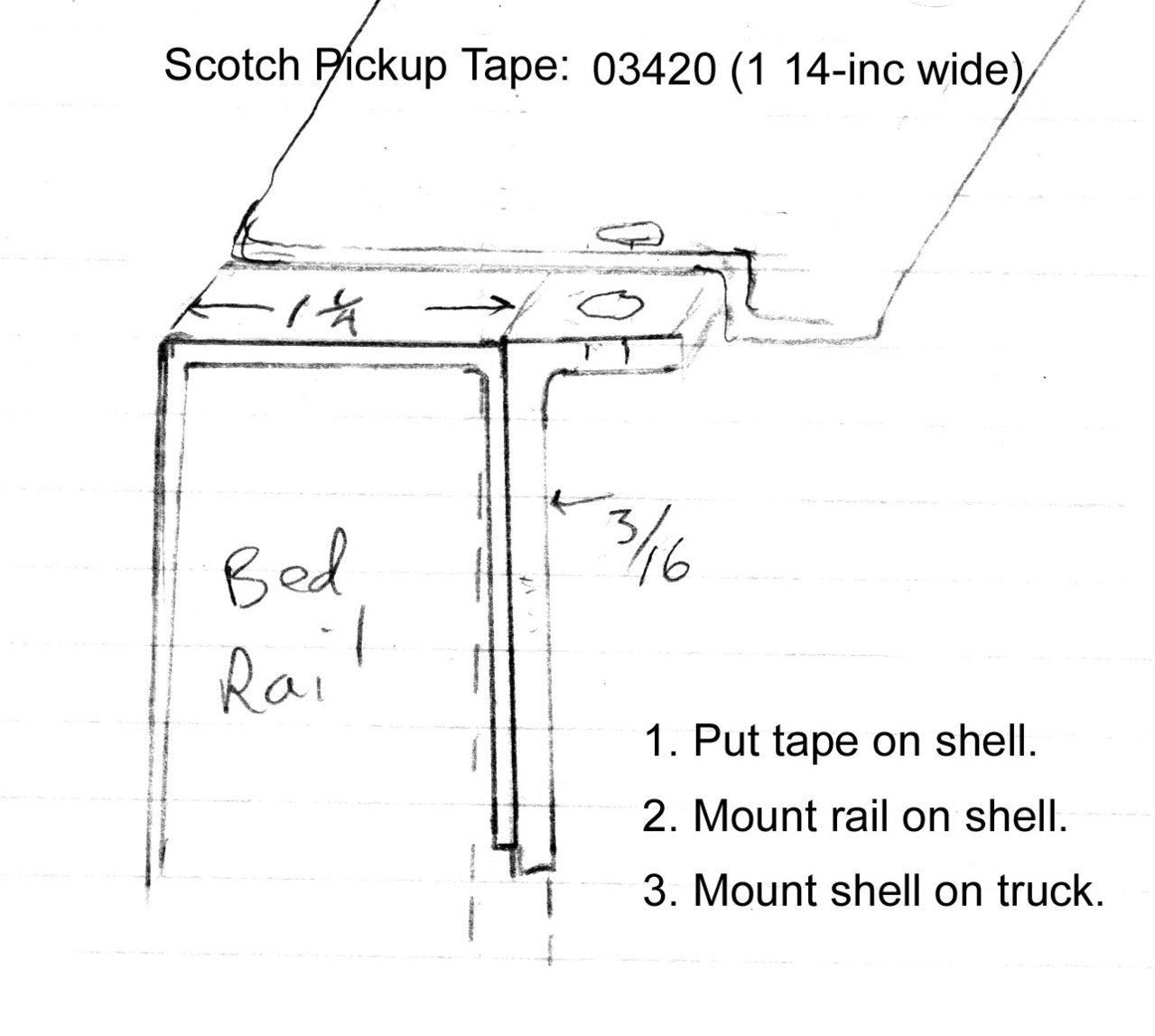

    Forget the clamps if you do any off-roading where there are a lot of roots, rocks, and ruts.
    When you mount your shell note that the inside part of the top rail of the bed is NOT perpendicular to the top of the rail. It bends towards the center of the bed a few degrees as it goes down. In the drawing below, a dotted line shows the perpendicular.
    On each side I use 4 screws and locknuts to hold the shell to a strip of angled 3/16" aluminum that I had made, and 4 screws and locknuts to hold the aluminum to the bed. The screws and nuts are stainless steel. I know the drawing is not really complete but you get the idea.
