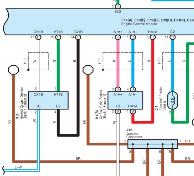

    2013 Toyota Tacoma I4. Oxygen sensor connection wires on the harness side are Black with shielded white wire inside, Blue, Green and black. Does anyone the locations they go to on the connector? The connector is numbered, but I don't know which wire goes where. Thanks

    Here you go.
    Pin 1 (Green)
    Pin 2 (Blue/White)
    Pin 3 (White)
    Pin 4 (Black)

    Thanks so much
