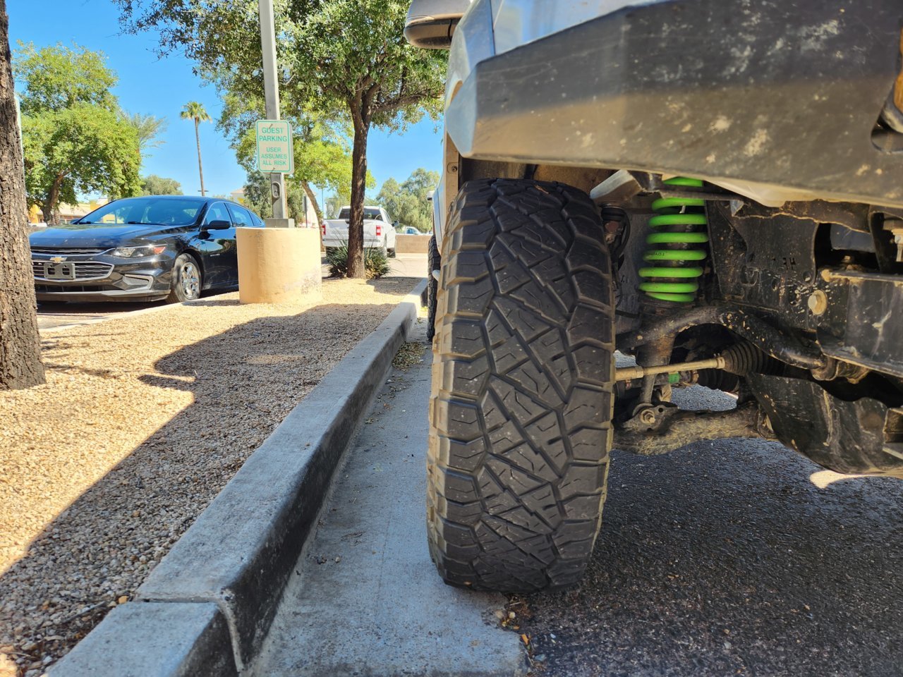

    Streets of Bakersfield
    2021 SSM Sport 4x4
    Well y'all... I'm in a bit of an SOS situation. I'm living in my truck right now on account of a nasty divorce situation. In Phoenix area to see my kids the next three days.
    I hit a nasty washout yesterday which I didn't see coming and my camber was absolutely screwed but I hobbled into phoenix on a hope and a prayer last night and took it to a shop this morning. I was hoping it was just alignment. Basically the shop said it was so bad that they recommend taking it to a collision center. He said the steering knuckle on the passengers side is bent and that the entire hub assembly needs to be replaced.
    I have an airbnb for the next three days to see my kids and absolutely have to make that happen. I haven't been able to see them in over a month. After that I need somewhere to take the truck on Friday to see how bad this is.. dude at the shop this morning said I'm likely looking at several thousand dollars especially if both sides need work... and of course I'm living in my truck right now so I need somewhere that's going to let me drive it away while they wait on parts.

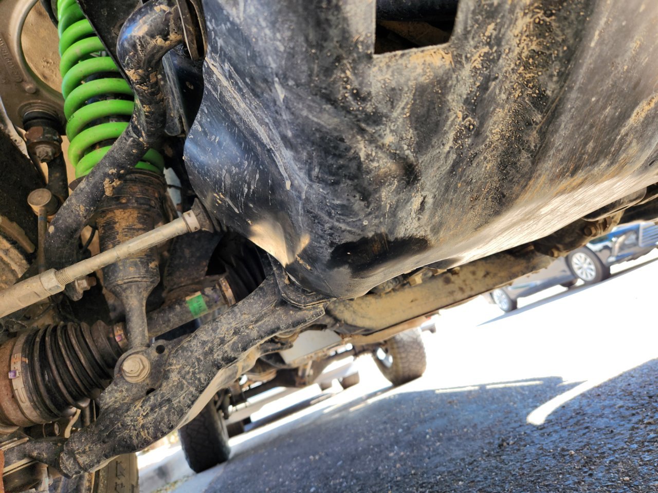

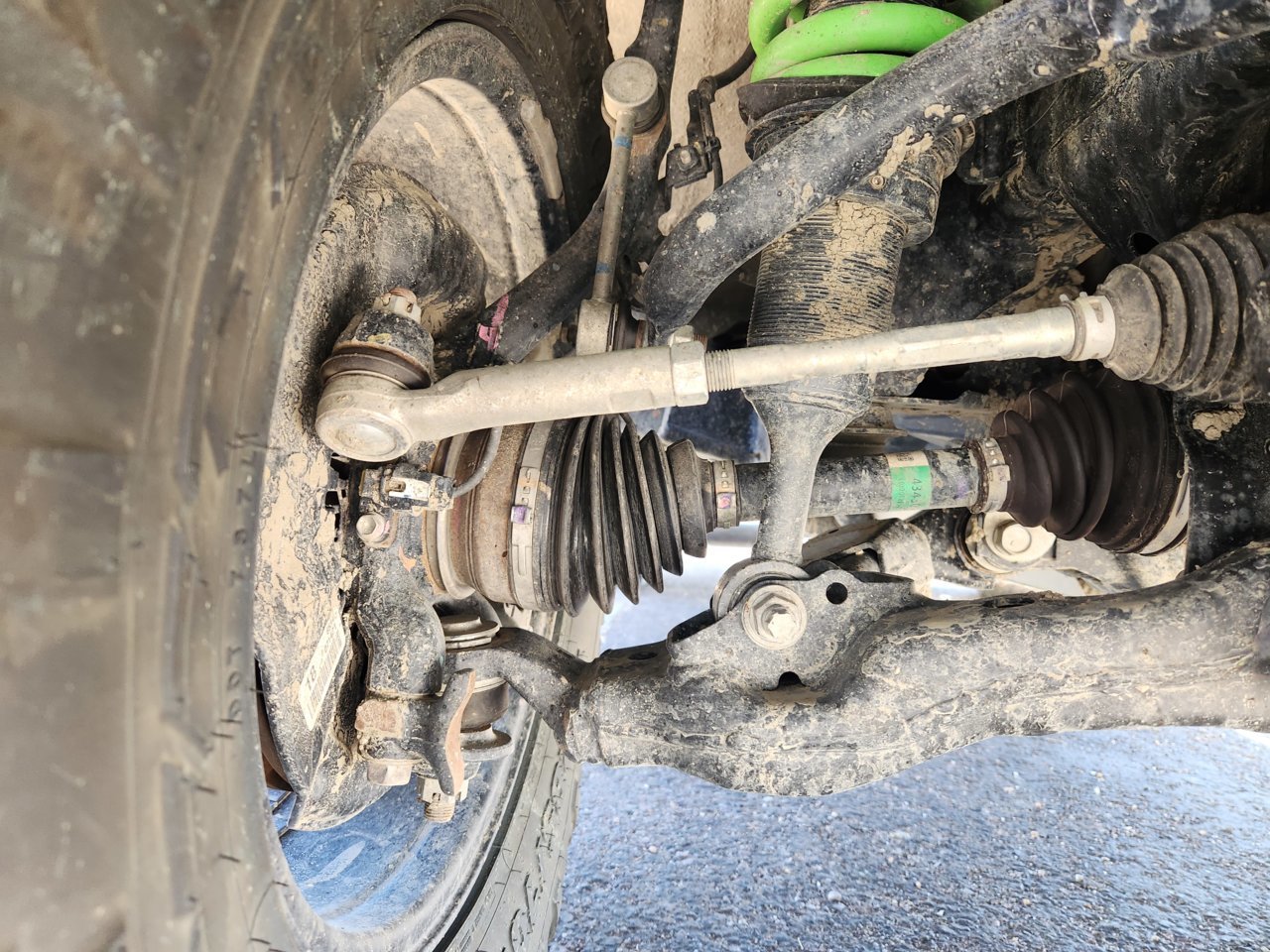

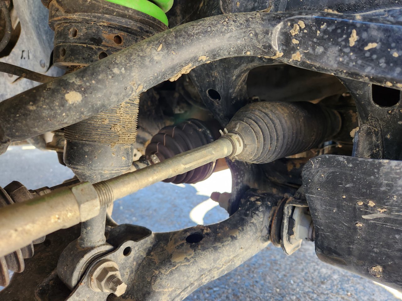

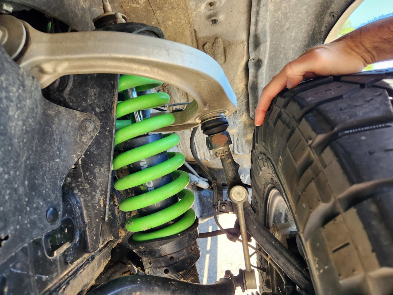

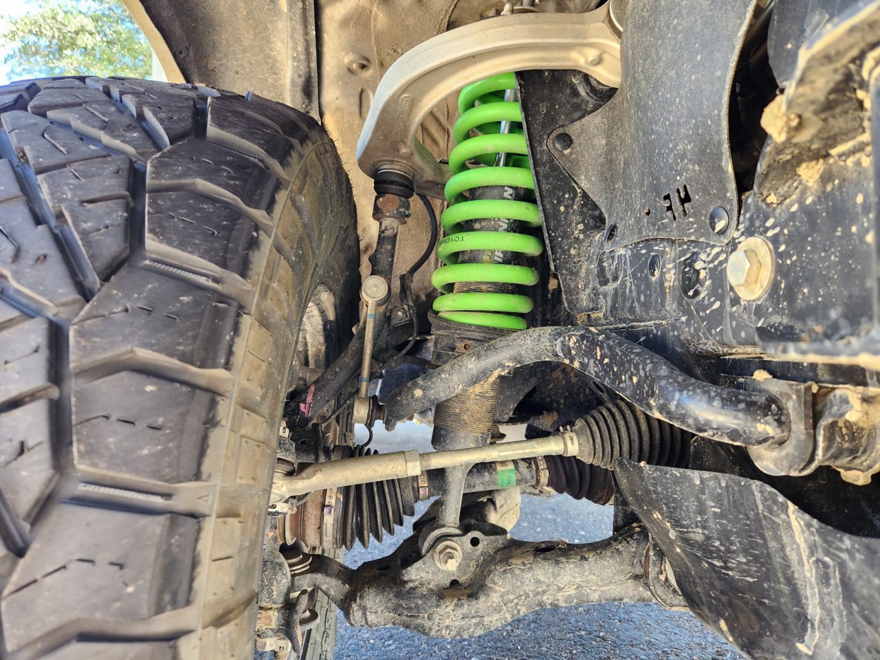

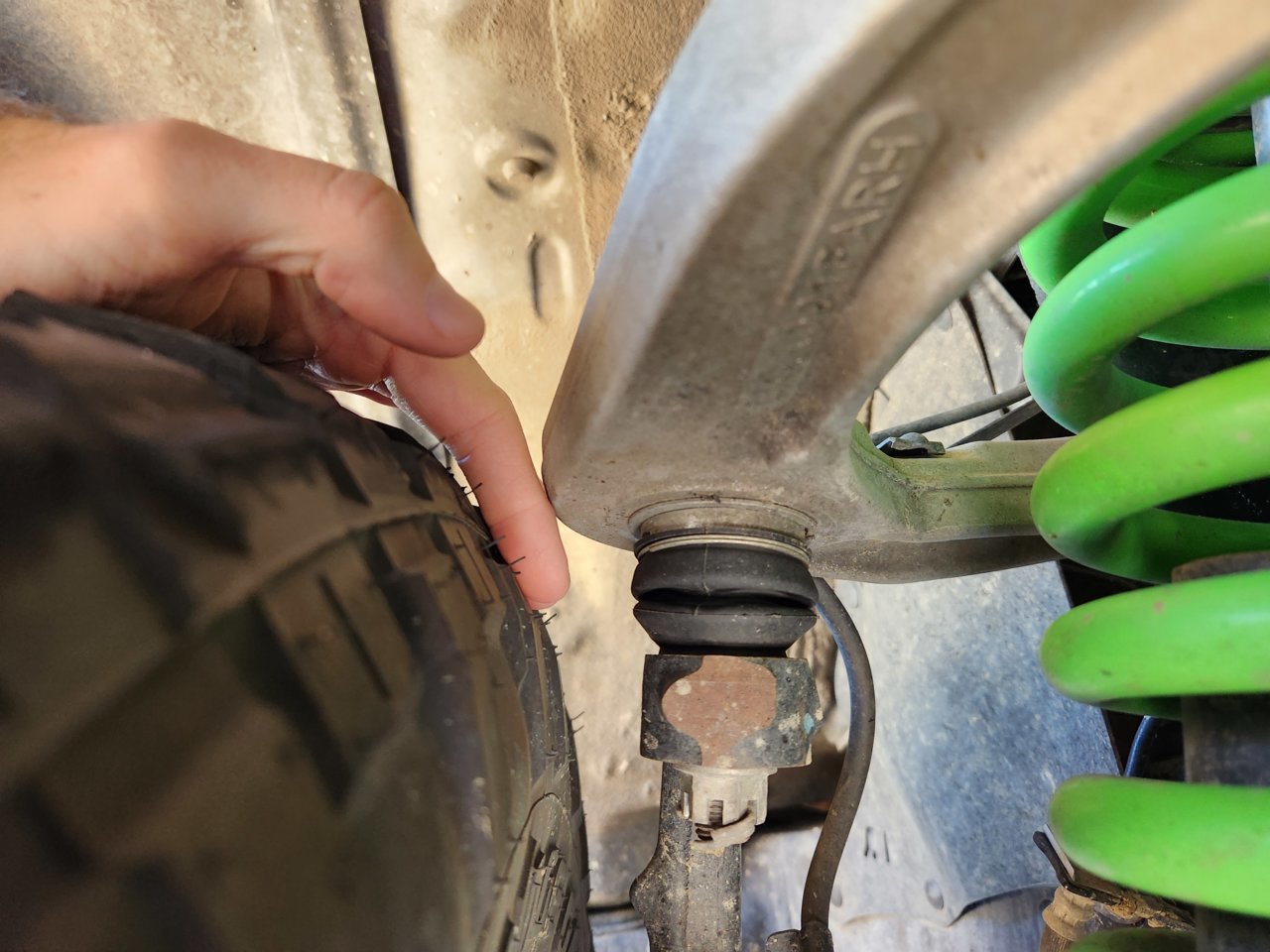

    Here are some photos...
    Passenger's side is definitely the problem side:
    Driver (which they said was also out of alignment but they didn't inspect in detail on account of the passenger being so bad):

    Are there any noises or vibrations coming from the front? I’ll shoot you a PM with my info.

    No noise that I've noticed except for what sounds like increased road noise from the tire I assume on account of the camber (but again I don't know what I'm talking about). No terribly noticeable vibration but it feels off for sure with the alignment being so jacked so it's hard to know what's what.

    Spindle for sure. I just gave my spare set to another local member.. but I think he kept his one good one (which was passenger side I think). There may be some others locally who have a spare spindle laying around..

    Yep agree with everyone else it looks to be a bent spindle. Hopefully there is one locally laying around. @Maxx is a great guy and should be able to get you taken care of. That is not a difficult job to tackle.
