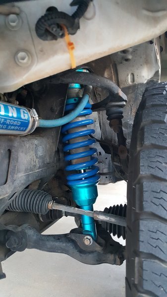

    So I recently traded in my 05 tacoma for a 2011 4x4 tacoma that already had some upgrades done to it and I have a few questions as to what else I can do. It has SPC UCAs and King coilovers with front fiberglass and in the rear it has a bed cage with King triple bypass 3.0x16" shocks. My question is other than going to Long Travel what can I do to lift the front end a bit more(I know since its 4x4 im kind of limited) Not too much but just a tad bit like an Inch. It already seems like the front coilovers are extended to their max.....any ideas?? I have attached pics for reference

    Sounds like you want to bro lean?
    I would leave em. But you might see about a 1/4 spacer on the top hat if you have enough threads.

    I don't necessarily want that much, just a tad bit more height in the front. Also due to the fact that my front coil overs seem to be extended pretty far. would adding that spacer and reducing the height adjustment on the front coil overs with the spacer make it ride better because it seems to ride stiff.....how does my truck look from your perspective?

    I think it looks fine. Its going to be pretty stiff if you have them cranked down.
    As far as loosening them and adding a very small spacer...i'm not sure.

    If it's the rake that you're not happy with, it would probably end up better for the handling of the truck and overall driveability to lower the rear instead of raising the front. If you just want to lift the front, you could install a heavier spring on the coilover...

    That. I don't actually see much shift in the CV at the angles you've provided... On mine the fins are just barely about to touch yours appear to be pretty close to stock. Springs could be under-weight for that plate bumper? How many miles did he put on that suspension?

    I bought the truck with them on it and put 10k miles on it so far. Im having them rebuilt in 2 weeks. The plate bumper is steel so that might call for different springs. This is why is posted this. Your guys' advice helps alot.

    Problem is: King (and many distributors) will build your shocks to your spec, so if the asked for a lighter spring for some reason...
    I think we need a full understanding of your suspension before it's as simple as "just install a spacer"
