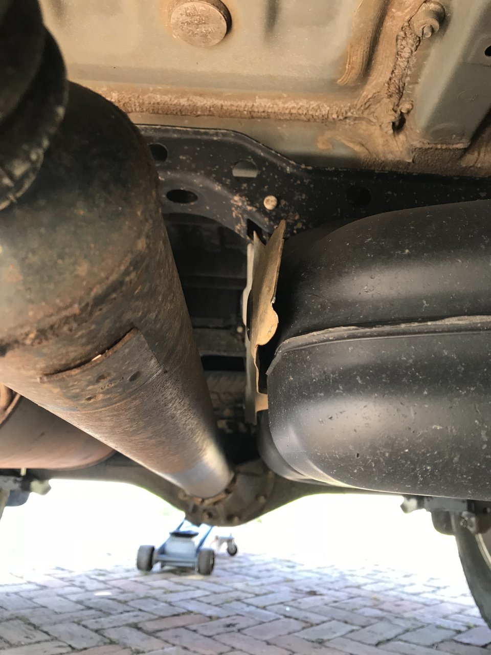

    It's been nice out so I've been riding the motorcycle, after getting super irritated yesterday (when I was driving the truck again and it was making that noise), I put the rear end up on jack stands, let the wheels spin, and got under there. Safety first, I know :bananadead: Turns out, a piece of the steel shield or whatever that goes around the gas tank somehow got bent out and was SLIGHTLY touching the driveshaft. I have no idea how I missed this in the other half dozen times I crawled under there looking for the problem...but that was the culprit. I guess it was good, made me stop being lazy and change the rear diff fluid and re-lube all the u joints. Thanks everyone for the replies, awesome community here.

    Thread revival but this helped a lot. Same thing was happening to me but I couldn’t tell where. Didn’t have enough time to really look though. Then I read this and went under today and it was the same. You can see the ring around the shaft where it was scraping. Thanks! Greased up the u joints while I was at it too.5F1A433F-1E9B-49DB-94A7-C166B2FF2C4C.jpg 6B68BEAF-1432-4F1D-B19F-D84B3333B7C4.jpg
