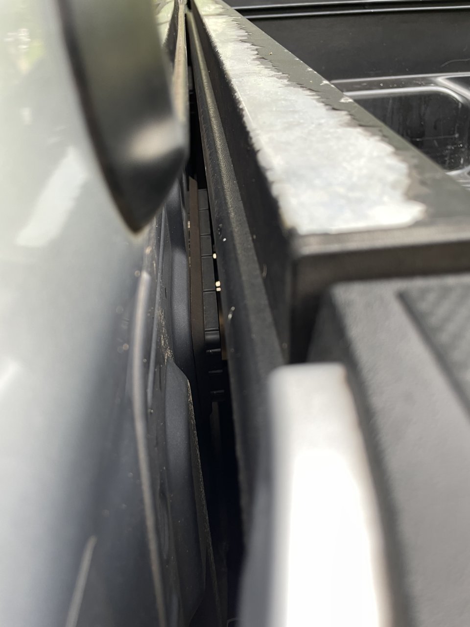

    Hey all!
    so I was having some issues with my subwoofer that I installed about a year and a half ago behind my back driver side seat. Took the seat out to find that my sub box was completely rotted and the carpet was quite damp. Was looking for the issue and determined it had to be the pressure vent (or air vent?) behind the seat that exits directly between the cap and the bed(I attached images). It is completely unsealed and has probably been letting in water for a significant amount of time. I’m not sure what to do. Should I seal it myself? Take it to the dealer for them to do basically nothing?
    If anyone else has had a similar issue please give me your thoughts on what I should do to resolve this problem. Thanks everyone.

    the leak is is coming from the pressure vent not the 3rd break light. I have confirmed that. Check the pictures

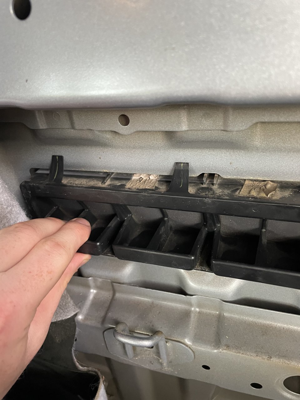

    If your for sure that it is the vent. I would push it out towards the bed to make the gap a little bit bigger. Then take some black RTV sealant and squeeze it into the gap. Pull the vent back to make it tight. Wipe off extra with a wet finger. And don't wash, or get wet for 24 hrs. No more leak.

    Toyota servicing center was useless so pulled out the rear seats and plastic storage and applied black rtv sealant around the vent to seal it from the inside. Seems to have worked perfectly. If the leaking is under the driver seat most likely coming from a different location. Check under your front and back driver side running boards for water damage and or holes.

    thanks for the response. it was under the drivers seat because it came in from the back and made its way to under the seat. it wet everything on the way. after looking today while in a down pour, i saw the vent leaking, mine is very loose in the cab - like your picture - like it loosened up over the years. i have 130k miles on mine so i run it hard and we are in a very high rain area. i will try the silicone, bet that does it. i had the 3rd brake light done at the dealership. i put high jet water on the brake light and monitored it, no leaks.

    there should be a rubber gasket around it. looks like it's there in second pic but not in the first. are those different sides?

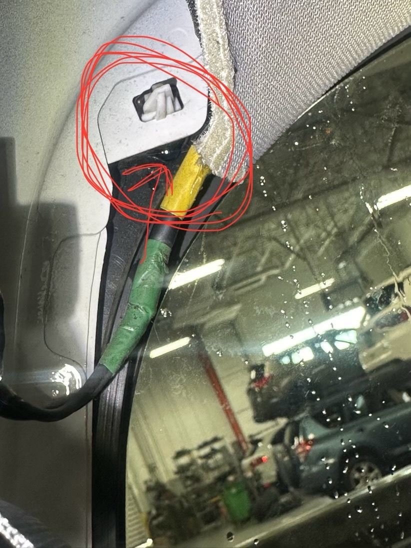

    I am currently dealing with the exact same situation with water coming in from the rear vents. Had the 3rd brake light replaced last year with an almost whole new interior installed due to the water intrusion. Took it back to the same dealer to have the review the seal as water was showing up on my rear window and floor, they found that the water was coming in on the passenger side where the rear window is mounted to the cab and the pressure relief vents. Currently removing the plastics and headliner to seal everything up and may end up put some sound deadening since everything is removed.

    I had the 3rd brake light replaced a couple years ago at Toyota after noticing rain pouring in the back. They redid my seats and carpet. About a year ago I started noticing water in the passenger side floor board front and back. Took it to Toyota 3 different times and spent hours waiting for them to figure it out. The put dye in the ac line to see if it was coming from there, checked clogged hoses, said it could be the ac evaporator or a seal on the roof but they couldn’t find the leak. Charged me $150 to diagnose but they never diagnosed anything. They basically said there is no leak even though they saw the water. My boyfriend started looking around and figured it out in 10 minutes. It was the pressure vent in the back on the passenger side. Water hose tested it and water was pouring through. Sealed it up with some weather sealant bc I be damned if I pay Toyota another dime to fix what they couldn’t diagnose in the first place.
