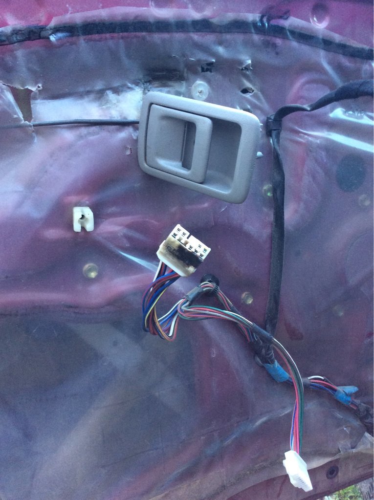

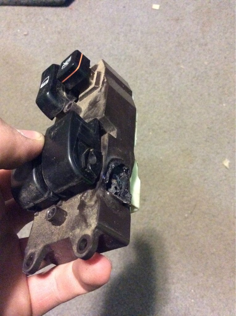

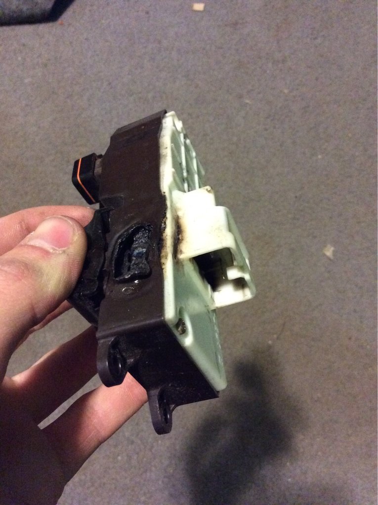

    My truck is getting a frame replacement and right now I'm in the "waiting" period. I'm not driving it right now so every weekend I start the truck and let it run for a bit. A few weeks ago I started having a dead battery and I would have to jump it off. I always made sure the key was out of the ignition and everything was turned off. Today when I went to crank it, the battery was dead so I hooked a battery charger to it and immediately I started smelling something burning. The charger is kinda old so I just assumed it was that and I unhooked it and tried smelling it and tested it on another battery and it was fine. So I hook it back up and all of the sudden my driver side window had rolled down and smoke was pouring out of the cab!! Unhooked everything and eventually found it was my window switch. The plug is burnt and the switch is burned up pretty bad. Anyone know why this could've happened? Shouldn't it have blown a fuse before this? 881f37bcd3b07db2e0b7bc384818f9bb_fbb5c04ef9b7f8ec161960fb81b1fbbbc8ad7caa.jpg

    You could take the switch apart to see if something inside grounded out.

    What is crazy is the button that burned up is the passenger side. Which tells me that something in the switch came loose. Take it apart.

    Did you hook up the charger backwards?

    Toyota had a recall on window switches (not on 1st gen.) The failure was similar to that. The cause was the window switch would stick partially and keep applying power to the motor in either the full up or full down position. This caused excessive current draw and would melt the switch. The recall procedure had us checking the switch for any type of binding, verify that there was no continuity when in the rest position and adding a thermal grease to the switch contacts. I had a few that had melted due to partially sticking. The burn pattern looked just like that. The recall designation was C0M. Given the amount of dirt on that switch, I would suspect that it might have been binding.
