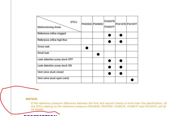

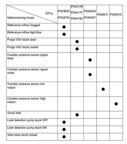

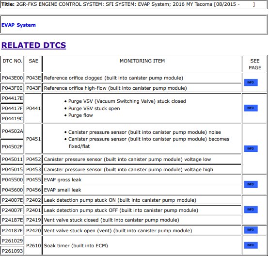

    star with a leak test.
    here are areas to check based on your codes
