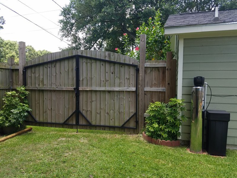

    Our 6x6's are in the ground 3.5' and we're on the GulfCoast, so.........
    You should be ok with 2' on a regular privacy fence.
