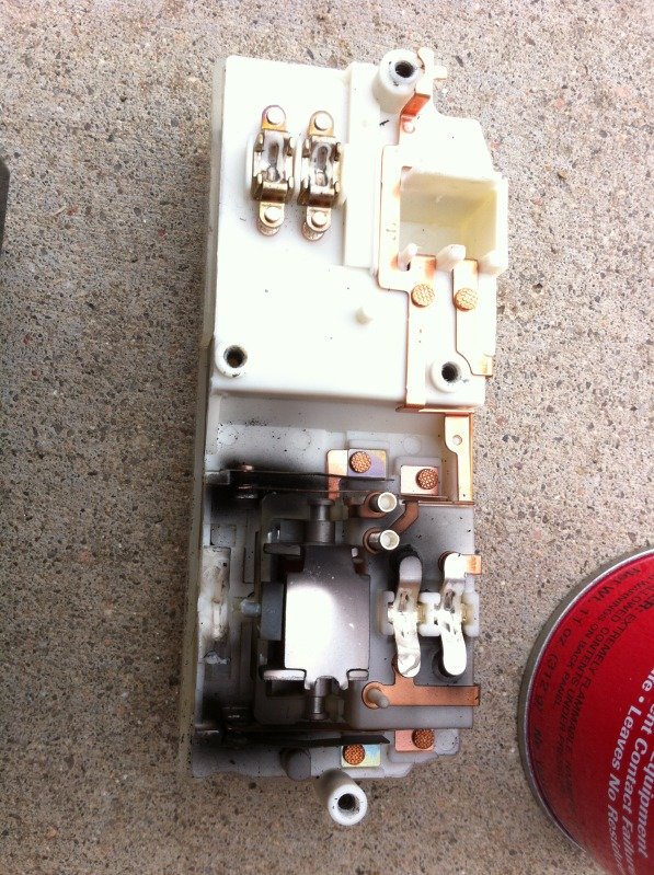

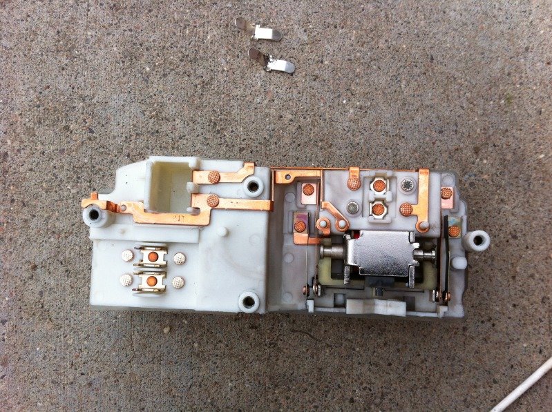

    I bet the contacts on your master switch assembly are dirty.
    First one to really get gunked up is the driver's side "up" contact. It's the one that has the longest duration, and most frequent, contact.
    1. Buy some electrical contact cleaner (Autozone, Walmart etc has it): http://www.autozone.com/miscellaneo...ts-cleaner/crc-electronic-cleaner/128435_0_0/
    2. Remove the master switch assembly from the driver's side door panel.
    3. Clean the contacts by spraying the cleaner on it. I also used q-tips.
    4. Reassemble
    It's exactly what I did and it cured the problem.
    Before. Those two long fin contacts are for your driver's side. Mine were coated in black residue.
    After. You can see how clean those fins are. I bet that is your problem.

    Why is it a bad idea? If the contacts are just dirty and the switch is fine, why not just clean the contacts? No need to buy a new switch. Plus that won't solve the problem if the contacts remain dirty.
