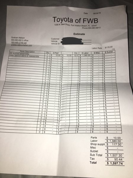

    Does anyone know how to, or where I can find, information on how to remove my moonroof, and track assembly? I need to clean it out due to image.jpg sand and grime in it. Otherwise I'm out 1500 dollars! -__-Thanks for the help guys!

    :eek: maybe take it to a body shop get another quote?

    why would the dealer charge you for that?

    Yea I did check other shops however I was granted a few months ago a platinum warranty from Toyota Corp for all of the shit my truck has been through. The primary concern at this point is I want to ensure the fix or whatever will be covered under warranty in regards to the platinum coverage. I would hate to lose that free warranty for potential future issues with the moonroof anyways. The service manager advised me to potentially let it sit and wait a while to see if the work I did to clean it continues to help it improve in functionality. That way if there is ever a future problem then I can use my warranty to fix the roof rather than my own money. I asked him if that would be a smart choice considering all of the "sugar" sand here but he said the way it looks now in the tracks resembles normal wear and tear for this area. Sorry for the long response.

    They have to remove the headliner to clean out the tracks and supposedly it's a really long process...

    I'll tell you I don't envy your situation with the moon roof. I think there is a reason they're charging you that much because they have to take a whole helluva lot of crap apart and there's some risk something could get damaged in the process. Same reason I dont like ripping apart the interior of my truck to add aftermarket stereo shit, because a lot of times that stuff never quite goes back together the same way it came from Factory.
    So with that I'd say you may be best to bite the bullet and have Toyota take it apart and fix it, at least then theyre on the hook to make sure it all goes back together properly. It surely isn't a job I'd want to tackle myself. At least not to do a real thorough job that's probably required to get all of the grit out.
