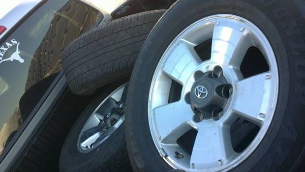

    1. They will fit, I did the same thing.
    2.New TPMS have to be flashed to your computer in order to work. Dealership cost $100, not sure what other tire shops charge, but you can sniff around for quotes.
    3.The steel wheel TPMS will not fit right into the 17" sport wheels or the 16" OR wheels. It's a different degree offset. You can take your tpms out of the old wheels and make a TPMS pipe bomb to fool your computer, or like I did, just put black tape over the light.
    4.If they are basically new, then no, they shouldn't be out of balance yet.

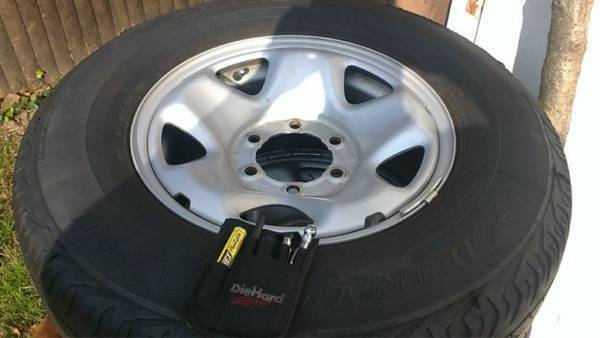

    5. Went from these
    To these
