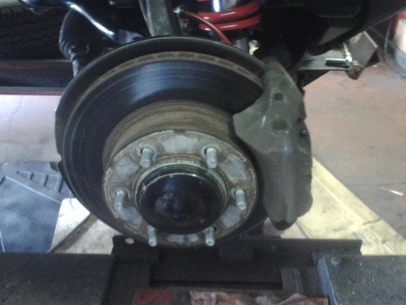

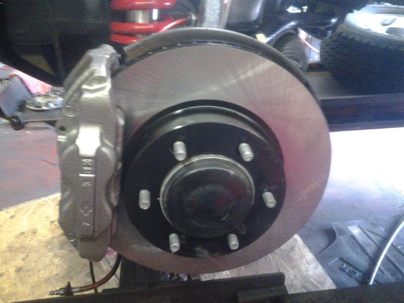

    Its a easy bolt on upgrade. Just had to trim a little off of the backing plates, i used tin snips. Besides changing the calibers, pads and rotors i also purchased new banjo bolts and steel braided brake hoses from Wheelers offroad. I also did this upgrade to my lifted 4runner. Search "Tundra brake upgrade" alot of info here if your interested.

    I bought the parts for a 06 tundra, 231mm calibers are the ones pictured that i installed on my 04 tacoma. My 2000 4runner i installed the 199mm calibers, also from a tundra. The 199's didn't require no trimming of the backing plates because they are slightly smaller than the 231's.
