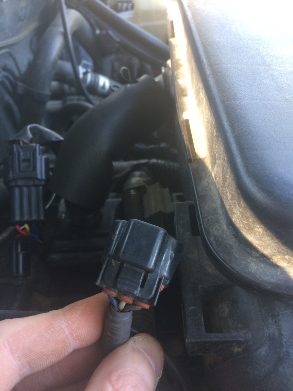

    Ok so I took my intake manifold off to change my coolant inlet pipe because it was leaking. Put everything back together, but while i was putting it back together i noticed the clip to the map sensor was still on but no wires. So i need help with a wiring diagram of the 3 wires that go into that clip. I tried looking at a friend's truck is a 2013 2.7l 4 cylinder but the wiring 3 wires (blue) (black)(brown). The wires on my truck which is a 2011 2.7l 4 cylinder is (blue)(grayish purple)(brown). Tried wiring like my buddies truck but won't start now. Plug my truck in and it shot me a p0106b code which is map sensor code. Any help is appreciated thank you

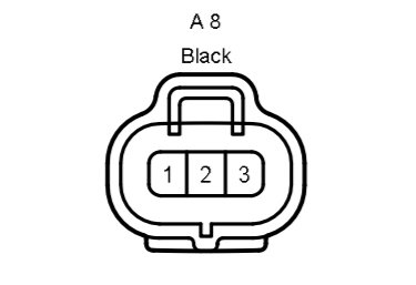

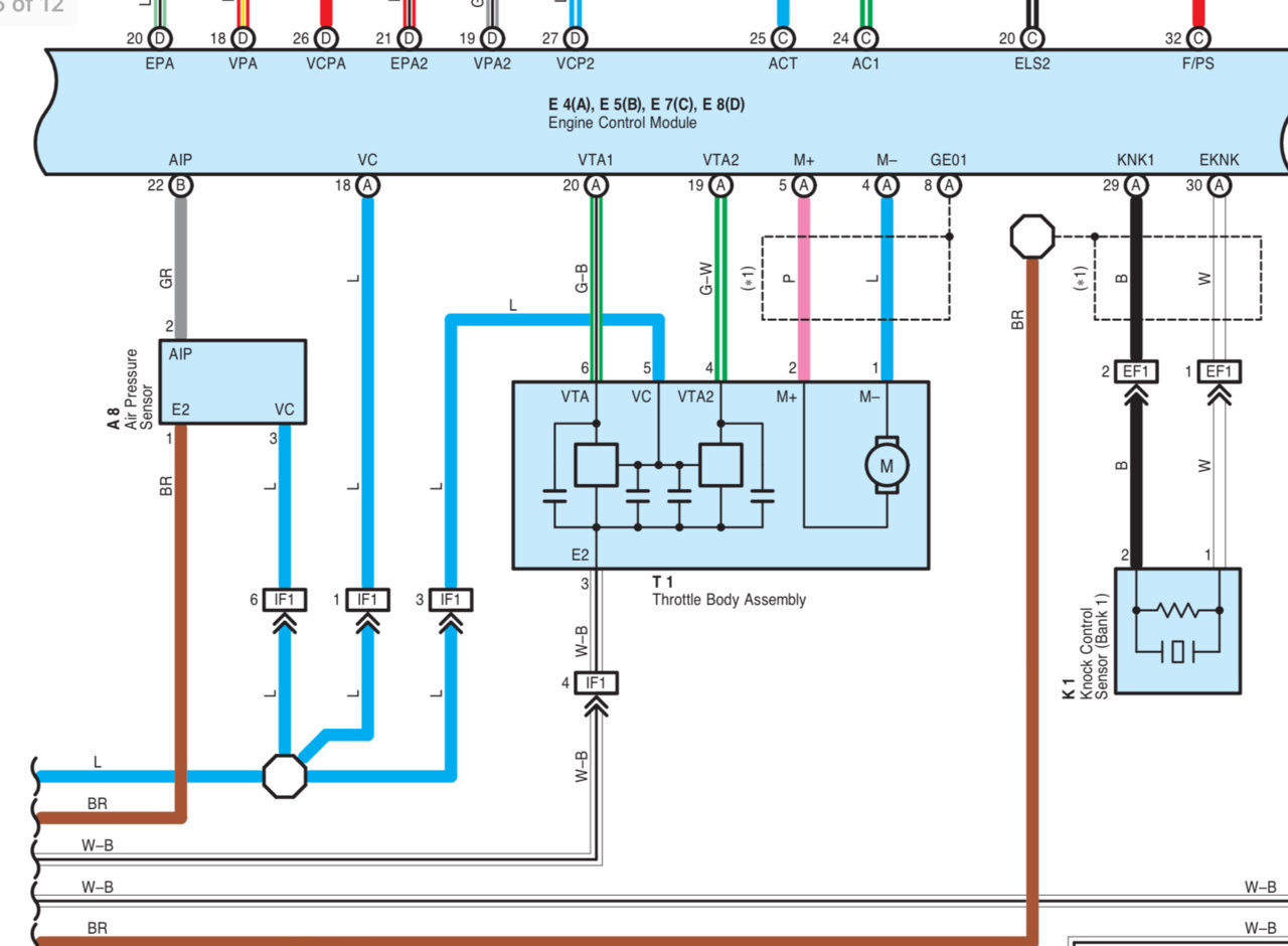

    Is this what you are looking for?

    Yes thank you

    Here it is on my 09
