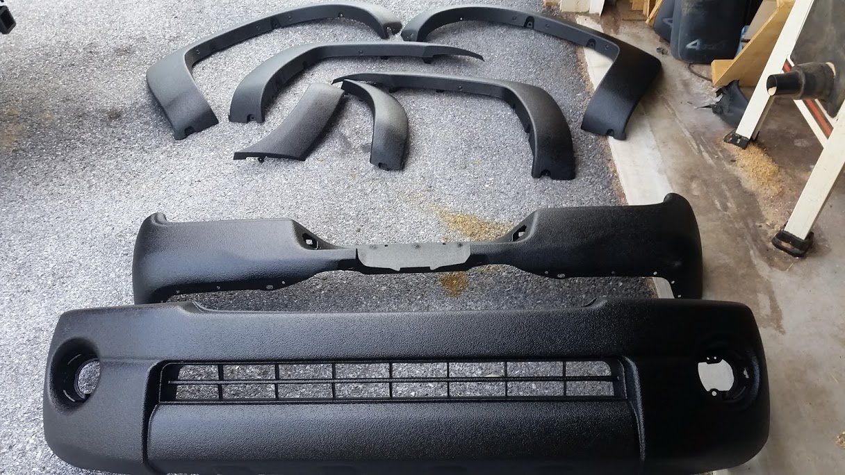

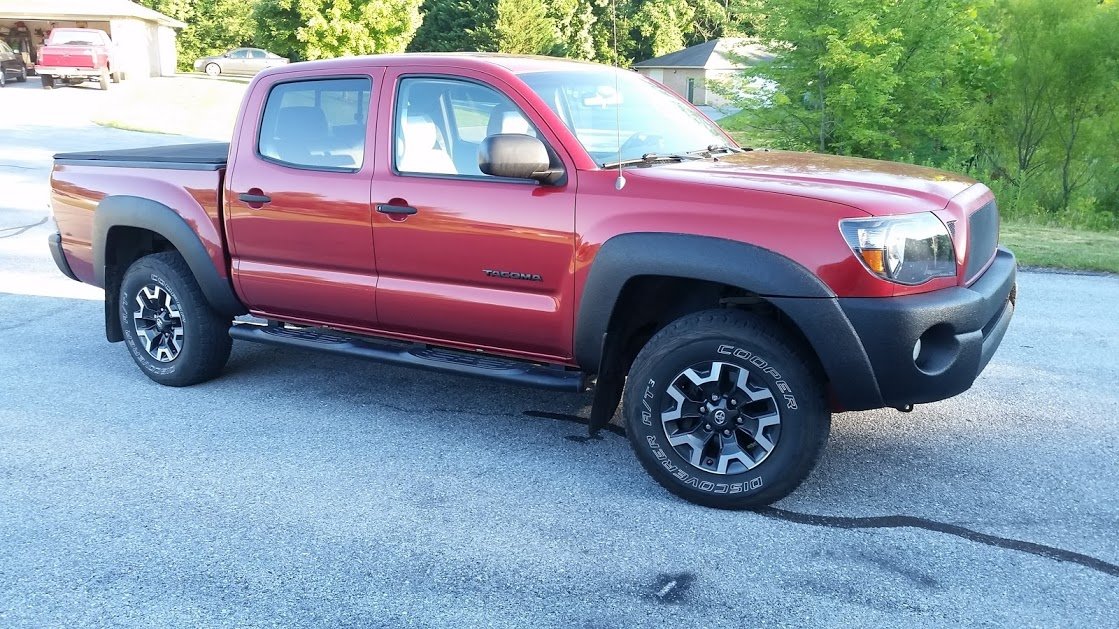

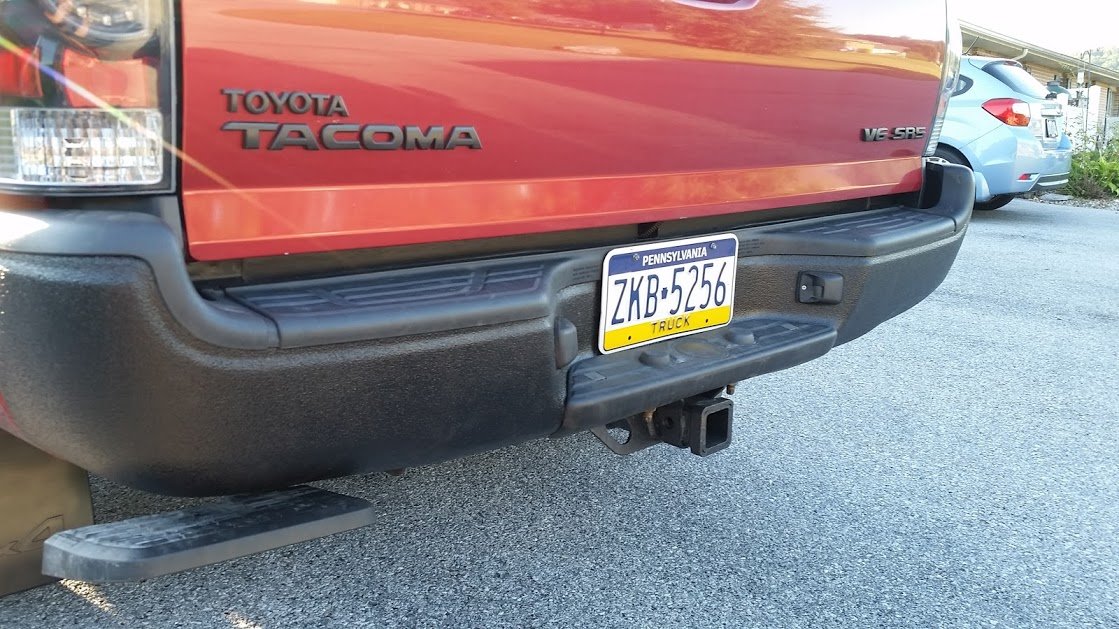

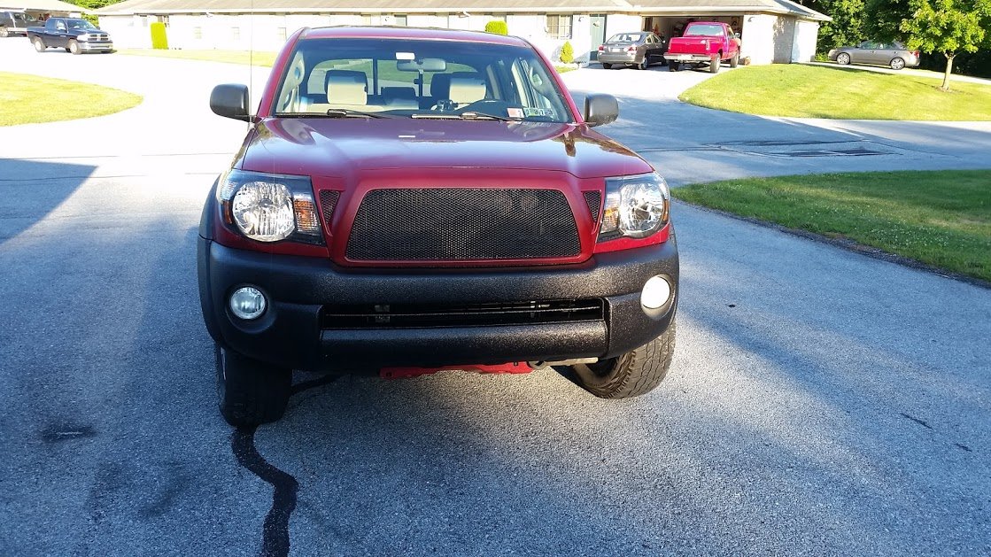

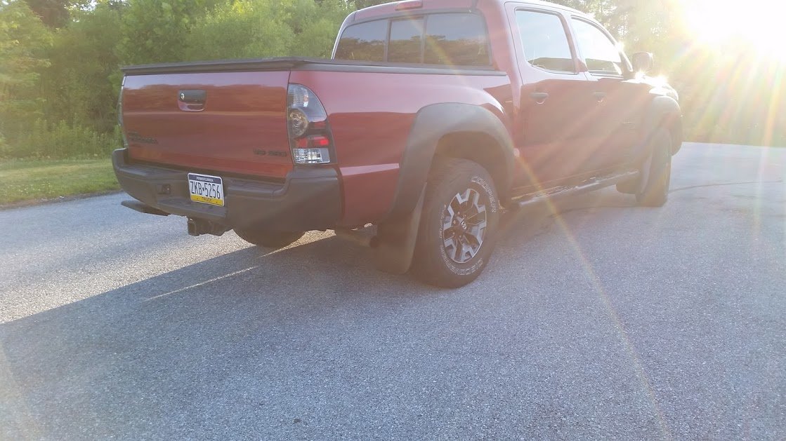

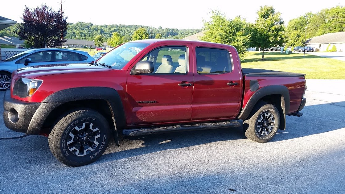

    Got the bumpers and flares installed this weekend. I think they look awesome!
    20170709_191732.jpg 20170709_191720.jpg 20170709_191646.jpg 20170709_191631.jpg 20170709_191620.jpg
    Drainbung and Longshoreman like this.

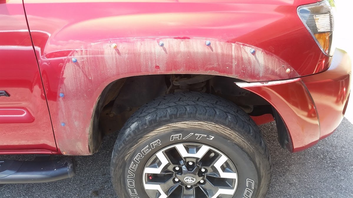

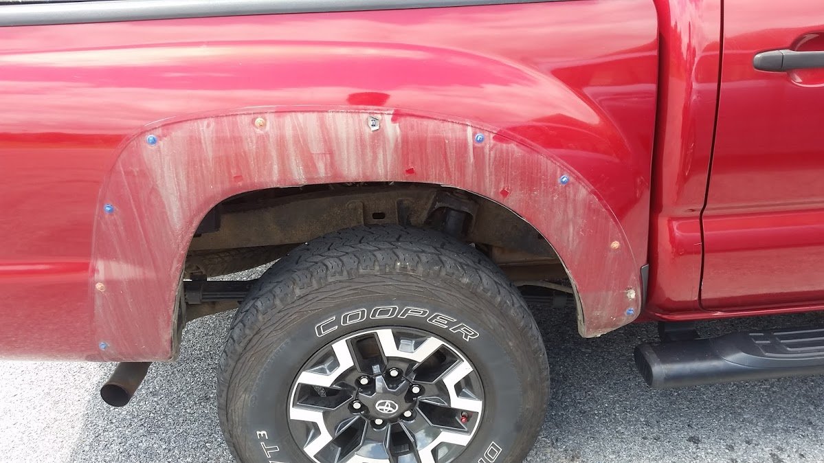

    Here are the parts that i ordered:
    Front Moulding: 53853-04040 - https://www.amazon.com/gp/product/B00FWPHRBS
    Read Moulding: 75659-04050 - https://www.amazon.com/gp/product/B00BJLWPAC
    Blue Clips: 75396-35020 - https://www.amazon.com/gp/product/B00GHQJNRC
    Orange Clips: 75397-35010 - https://www.amazon.com/gp/product/B00IKPEX0A
    Its a lot easier to put the clips in the flare before attaching to the truck. I learned that the hard way...
    Also here are images of the clips. I cant remember which one the "grey" one is. Part of the flare broke off. Will have to see what fits in that hole.
