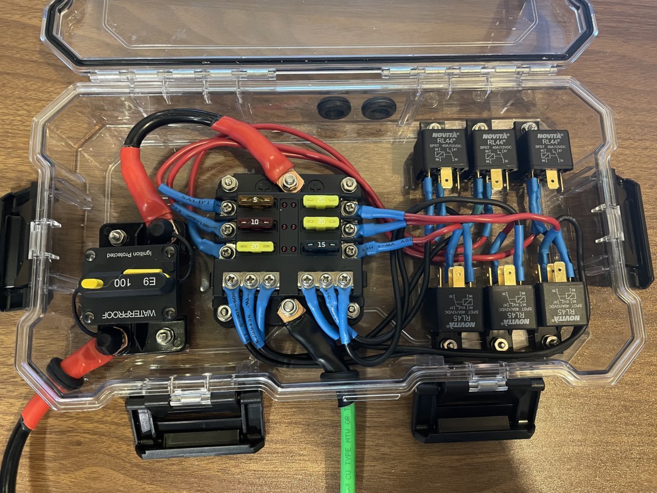

    Need to look for volt / amp draw and in line fuses. I think some harnesses vary and not a universal one fits all

    Doing things the right way is definitely going to mean different things to different people. I would recommend routing all your auxiliary lighting through a breaker, fuse, and relay. I made up this box for my stuff. It's more than what you need for now but something smaller but similar could be put together relatively cheaply. 497AB38A-2FFA-401E-AAE2-1D9A008F229F.jpg
