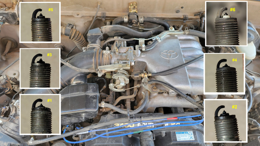

    02 Prerunner, 3.4, 286K. Last fall, replaced air boot, injectors (orig), fuel pressure regulator (orig), plugs, wires, coils. Cleaned MAF. Ran well.
    Just now started barely running, very rough. Smoking (white). Fuel pressure was erratic around 42, but dropped instantly when shut off. Had all kinds of codes: 0440 type, 0300 type, 0171,172.
    Replaced pump (orig), purge valve (orig) and upstream o2 sensor (orig). Tested coils w meter and examined plugs (photo attached)
    Oil clean. Coolant clean. Fuel pressure steady at 42, but drops off fairly quickly after shutoff.
    It's now a little smoother at startup, but becomes rough and smokes a lot. Ran codes, 302,304,306. I am mystified.

    One glaring thing stands out. You're using single electrode plugs. Pretty sure that little white and blue label in your pic says specifically not to use single electrode plugs in favor of dual electrode.
    I'd get some Denso/NGK/OEM dual electrode plugs in there. If you're getting misfires on the drivers side I'd be triple checking your wires are correctly connected to the coil packs.
    After that I'd be looking to do compression test, and most probably a leak down test.

    cylinders #6 and 3 share he same ignition coil. I would swap that coil with another and see if the misfires follows the coil, if so, easy diagnosis. The one thing I do see is that cylinder #6 plug looks as if it isnt getting fuel or that is where the coolant is "cleaning" that plug. Pull the plug on #6 and start her and tell us if water/coolant squirts out, if no, then do a complete compression test.

    Good morning. Thanks for the responses, and catching my ignorance to the plugs! You'd think after owning this truck from day 1, I would've read that sticker by now. Swapped out w NGKs. Swapped coils around. Still white smoke, gets worse after a minute.

    agree with Glamisman re: #6 plug either no fuel or getting steam cleaned
    peek at top of cylinder on #6 when u get borescope.....if top of piston is steam cleaned, there is your proof of HG issue
