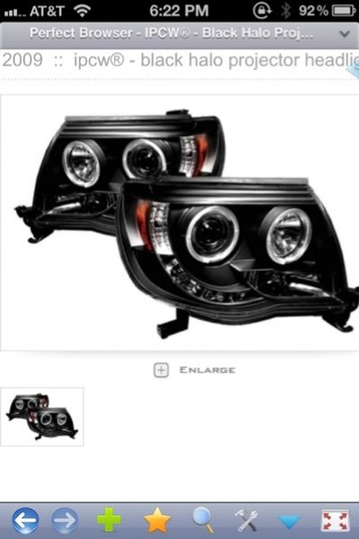

    I'm looking for new headlights, not bulbs. Something like this:

    What he's trying to tell you is the Ebay projector lights, like the ones you posted, actually have worse light output than the stock headlights. The best way to put your current HID set up to work is to throw then into a set of projectors. It will throw the light better and give you a nice, clean cut off.
    If you just want a blacked out OEM looking light, try Ebay but make sure you seal them up with silicone before mounting because they have a tendancy to leak otherwise...

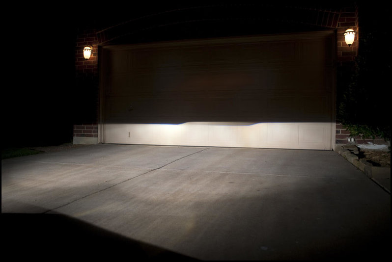

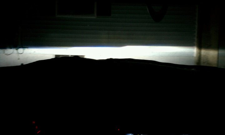

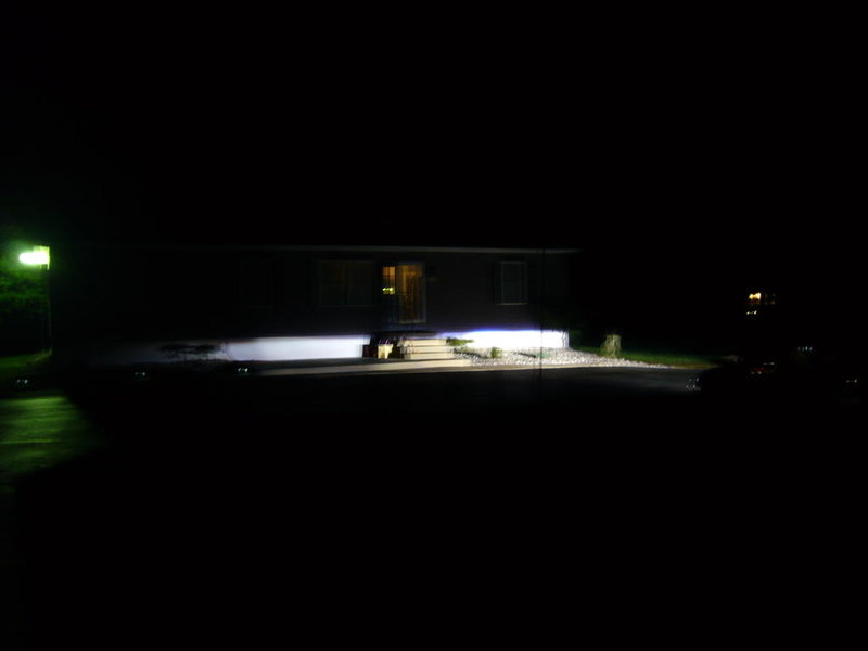

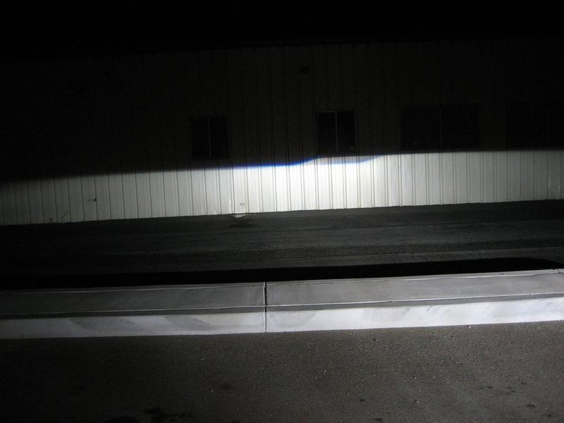

    i think this is what you want lol.
    i have ran all three in the last year on my truck. i have had 2 sets of the d2's one set of H1's and now the modded fx-rs pushed with 55 watt ballast.
    here is some pics of my old d2's and some i pulled from around the site when i was looking for projectors. sorry my pics of these suck dude lol. also a link for my fx-r retrofit.
    i don't have any pics of my H1's but, they where as nice as my fx-rs. almost as much color and just a hair more narrow but more light in the foreground. so they lit up like 5 lanes across and had very nice color mine where modded by a retrofitter however for more color.
    imo in our trucks the fx-r is a great choice due to the foreground limiter it has. basically that projector saves that light to be thrown out further in front which make for an intense and consistent cutoff. instead of having light being wasted right in front where you won't even see it due to the ride height of our trucks especially when lifted.
