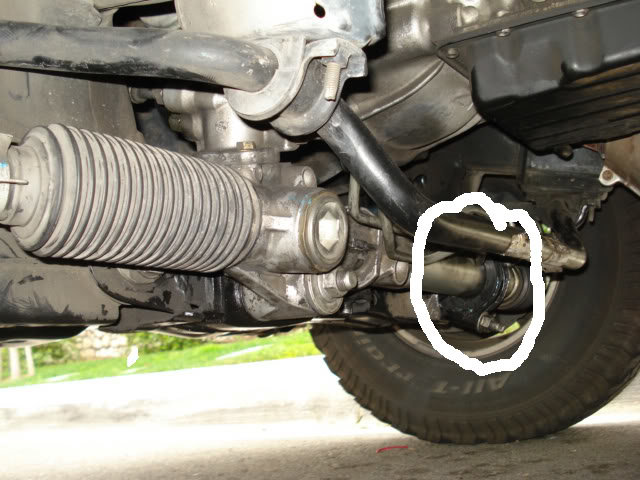

    Could the rack and pinion be making the noise. I know it bolts to the cross member under there.

    Maybe, can you possibly send a pic of where it's mounted so I can take a look? Thanks for the suggestion!

    Not my pic.

    Check the inner and outer tie rods on the rack and pinion

    So am I supposed to be able to twist the entire tie rod with it still bolted up? I read somewhere that it shouldn't rotate at all.
  17. Sep 22, 2019 at 1:28 PM
    #17
    tcjacado
    tcjacado Well-Known Member
    Aug 29, 2016
    #195947
    41,570
    Pretty sure there should be little to no movement (play--- twisting or otherwise) except when articulating, bouncing up and down on washboard roads etc...
