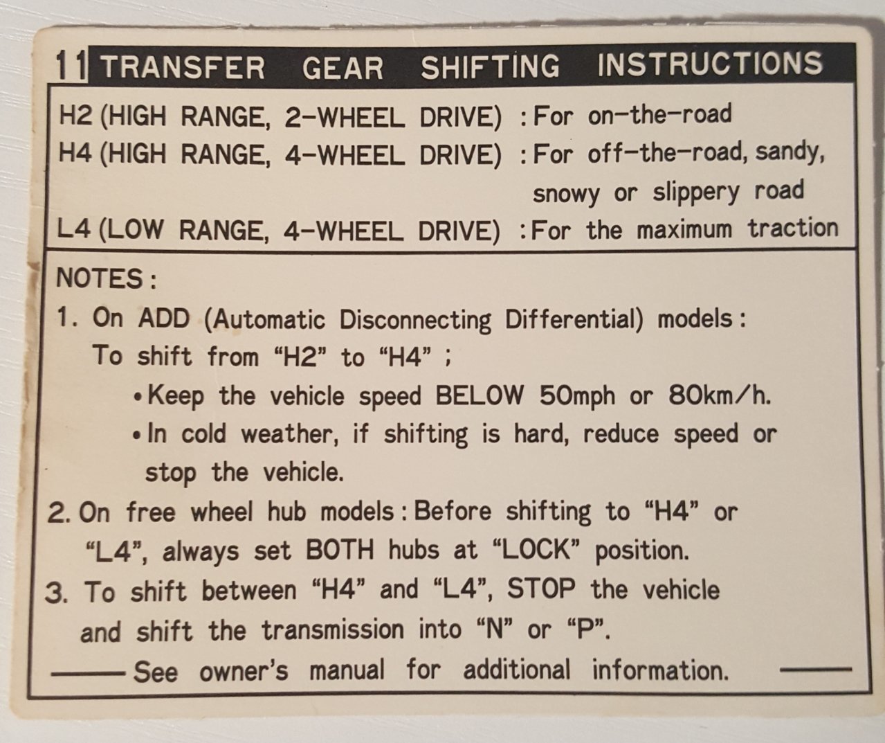

    Valid point, edited my post to clarify highways aren't dry here. Official guidance for a manual tcase agrees with you.
    I'm on original tcase at 230k but ymmv.
