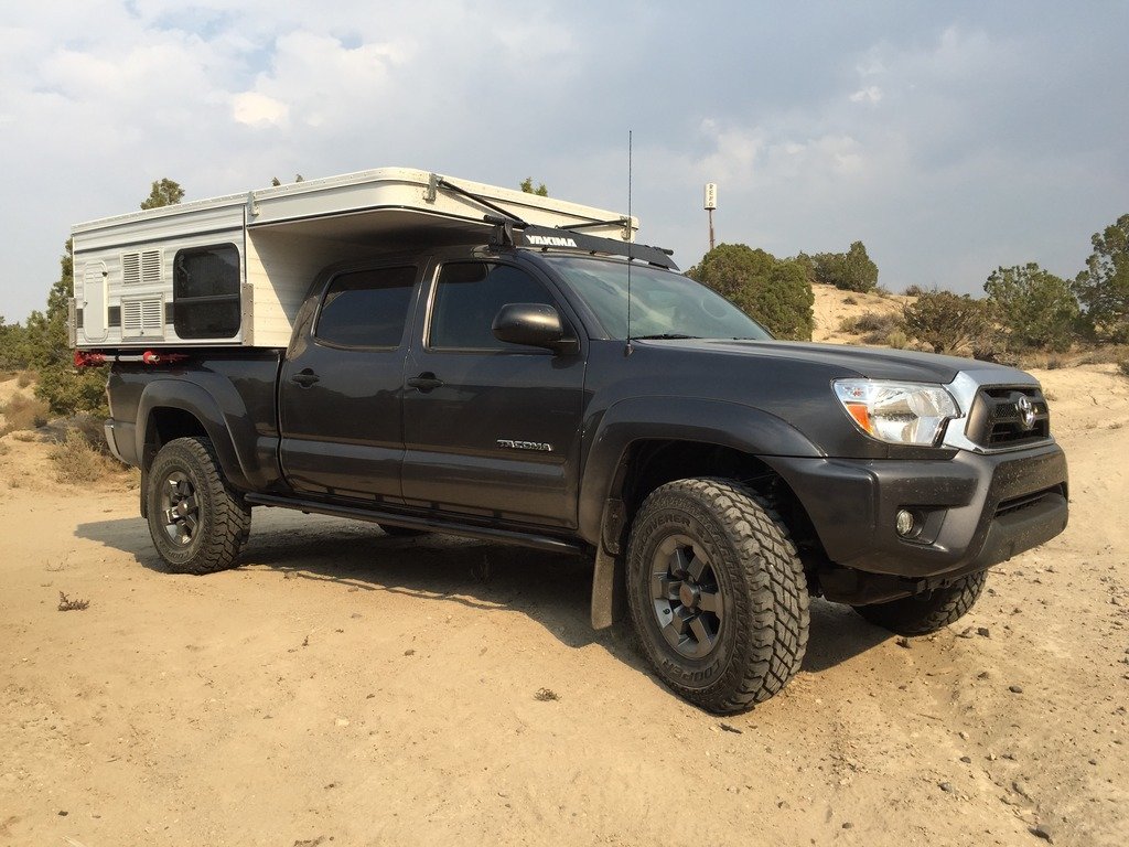

    FYI you're way over 400lbs past GVWR. ;) I don't even have bumpers on my '15 with FWC, you're underestimating. Which is fine, just giving you a heads up.
    Let's see what you're setup looks like, and get some more info. The "spring pack" is a full leaf spring pack, right? Rather the hellwig add a leaf pack, that adds on to your stock springs? What shocks? How much air pressure in the air bags?
    What size/rating are the tires? E rated? What psi are you running now? What shocks are you using.
    So I have a 2015 DCLB with fleet camper, fully optioned. I'm running icon 2.5" coilovers, icon rear 2.5" shocks valved firmer than normal, with adjustable compression valving all around. Using old man emu Dakar leaf springs with an add a leaf, and and overload removed. And I'm using a taller and softer timbren hollow rubber spring. E rated cooper Maxx St tires (255/85r16). Very very happy with it off highway and on rough roads. On the highway I ran somewhere around 45psi up front and 55psi in back. On rough washboard roads, even a small amount makes a huge difference. A drop to 40/50psi makes a difference, and 35/45 helps even more. Just play with pressure a bit. Also I wouldn't use so much pressure in the air bags that your raising the truck above stock. In my opinion, the truck would ride better if most of the weight is carried on the spring. Again just have to play with it.
    Having all the weight on the back (especially with a bumper back there too) make cause the whole setup to buck around a bit. Having the front suspension cranked up too high may do the same.
    Interested to see what your suspension setup looks like though.
    Here is my truck and camper.
    For what it's worth I'm having custom leaf springs made for the truck in the next couple weeks. The Dakar springs are incredibly noisy, and the timbrens are restricting overall suspension travel. It works well but I'm looking for something a little more supple with more room to travel.
